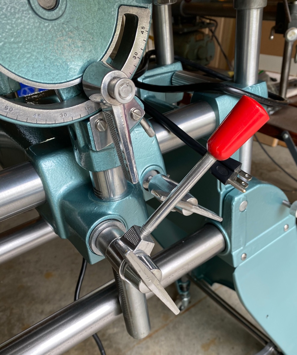

Where I really get a lot of “wow factor” on restorations is from the bare metal surfaces. Since I do a fair number of these, I have tried to at least mechanize some of the work (sanding pads under a palm sander for first pass cleanup on flat surfaces, custom jig for cleaning/polishing tubes), but a lot of it is still hand sanding and polishing, especially if I’m trying to achieve a “showroom new” look on a 70-year-old machine.
I don’t know what the original surface condition was on your vintage machine, but the early Greenie Mark 5 models had very nice polished surfaces on the aluminum knobs and handles, and you need to avoid using a wire wheel on those, as it’ll mar that original polished surface that’s usually still sitting there under decades of grime! In those cases, it’s fine steel wool and Blue Magic brand metal polish to bring them back to life:

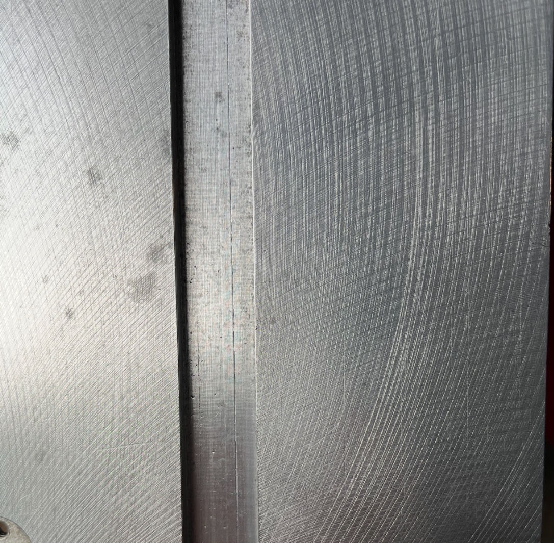

I’ve also spent a lot of time following the contours of the original machining marks on tables (they accidentally created some beautiful Art Deco looks on older models that are worth preserving!) with delicate hand sanding and steel wool, but that’s not going to be relevant on a 520 style table…

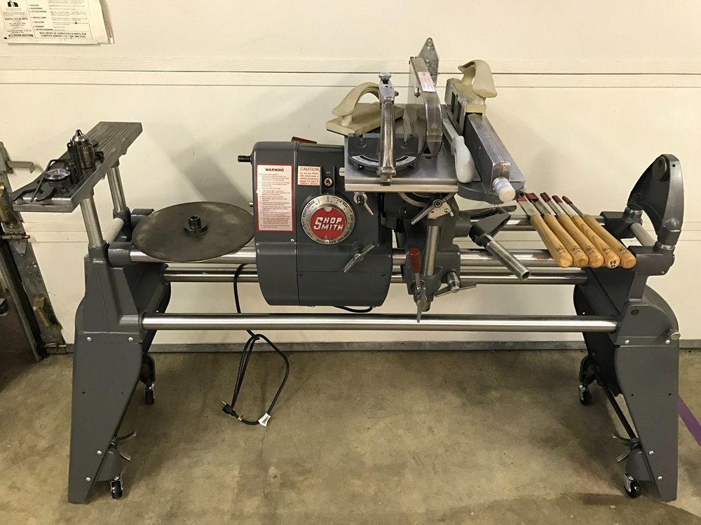

Like John my restorations vary depending on which Shopsmith tool is being restored. I have done full restorations on Shopsmith tools ranging from 2 of the original Model 10E's from the first shipment sent out by Magna Engineering Corporation in 1947 to a 1982 Mark V and many in-between. Newer Shopsmith tools don't always need a full restoration, but some touch up work can make them look new. I use many of the same techniques as John and since I have done so many I have a jig setup for turning the Way and Bench Tubes on a Mark for polishing.
It appears the main focus for your Mark V is the paint. You have two main choices there. The first is to use the Shopsmith paint which is expensive compared to another alternative paint. Do get the correct formula paint from Shopsmith if you go that route. That is the Gray for tools made prior to 10/01/2001. The other option is to use paint from another source. For the Model 10's I have restored I use Rustoleum Charcoal Gray Paint. That is a gloss paint but I add a coat of Matte finish to dull the gloss down.
I restored the 1982 Mark V 8 years ago and used 3 cans of the Shopsmith Gray (prior to 10/01/2001) paint. Since then, the cost of that paint has almost doubled. The Rustoleum Charcoal Gray Paint I use has about doubled in price since then too. Add to that the cost of the Rustoleum Matte Clear Coat and any paint job done to a Shopsmith tool has increased a lot in the last decade.
Below is that restored 1982 Mark V.

jpdalton wrote: Fri Feb 14, 2025 7:18 am Where I really get a lot of “wow factor” on restorations is from the bare metal surfaces. Since I do a fair number of these, I have tried to at least mechanize some of the work (sanding pads under a palm sander for first pass cleanup on flat surfaces, custom jig for cleaning/polishing tubes), but a lot of it is still hand sanding and polishing, especially if I’m trying to achieve a “showroom new” look on a 70-year-old machine.
The tubes on my upgraded Mark V are still nice and shiny and free of pits. I've had good luck polishing the cast iron tables on my jointer and bandsaw but mixed results on the aluminum tables. I hadn't thought about polishing the aluminum knobs, handles, and miter gauge grip but after seeing your pictures I think I'll give the Blue Magic polish and steel wool a try. Thanks!
