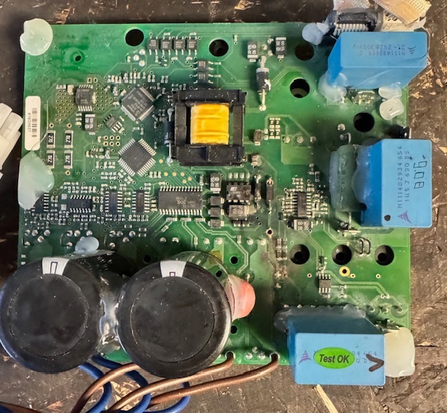

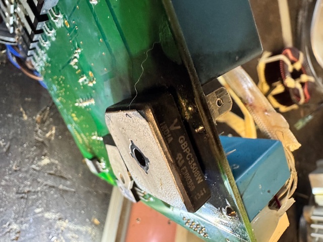

I’m the buyer on FB that purchased this from John. Small world haha! Anyways I tore it apart and it looks like the capacitors look good but it appears to have fried the rectifier bridge- lots of black and over heating around that component. I just ordered a new one $10 on Amz. We’ll see if that solves the problem and save me from buying a new power supply @ $600! Stay tuned.

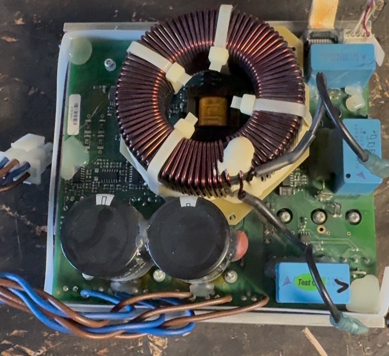

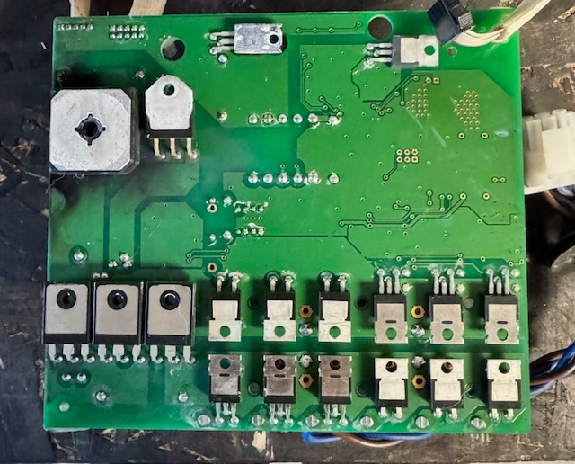

You’ll see John’s name on one of the original posts who authored this topic. I bought the SS from him after it wouldn't work and decided to dive into the project to try and fix it myself.
Here’s some initial pics of diving into the power supply and possibly locating the culprit? Hope they are helpful. Could use a schematic but what looks like a burned out Rectifier Bridge will be where I start.

nmac wrote: Mon Feb 24, 2025 5:27 pm Here’s some initial pics of diving into the power supply and possibly locating the culprit? Hope they are helpful. Could use a schematic but what looks like a burned out Rectifier Bridge will be where I start.
Does that rectifier, and other components on that side of the CCA, make physical contact with the main heat sink? What was the condition of the heat sink compound between those components and the heat sink? (Greasy or dried out?) Do the power input lines go directly to that rectifier?

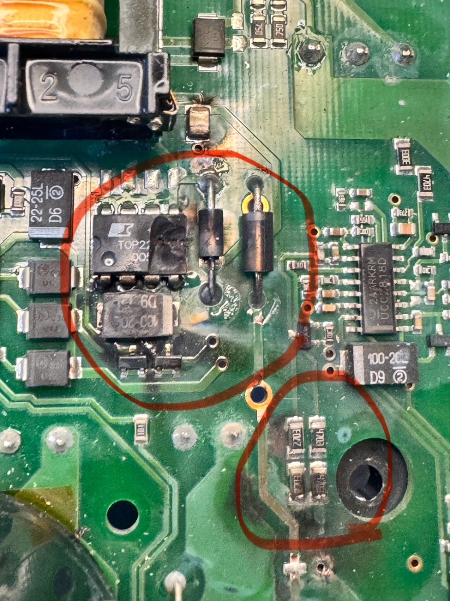

Hi David, The heat sink was dry. But after closer inspection it looks like there is more damage beyond the bridge rectifier. See new pics. Those other components are burned and cant read the part numbers? Anyone have an old power supply we can take apart? This is where schematics would really help. Anyone know how I could get those part numbers and see if I can get this back running?

nmac wrote: Thu Feb 27, 2025 6:14 pm Hi David, The heat sink was dry. But after closer inspection it looks like there is more damage beyond the bridge rectifier. See new pics. Those other components are burned and cant read the part numbers? Anyone have an old power supply we can take apart? This is where schematics would really help. Anyone know how I could get those part numbers and see if I can get this back running?
First, sorry that this happened to you. Know that I am an Electrical Engineer, but even before this I was always taking things apart, fixing them if I could, etc. so I have a little more knowledge than the average person related to PCB/electronics repair. I doubt that you will find schematics to help you, but you can try to search. The DVR motor that Shopsmith uses in the PowerPro was designed by a company called Striatech, but Teknatool is the one that integrates everything and distributes it. Shopsmith uses a version of their design, but customized for the PowerPro. Shopsmith historically has never provided internal documentation like schematics, etc. so I doubt you will have luck getting this info. Even without schematics, you can still attempt a repair/replace on damaged parts of a PCB like this. Know that systematically replacing damaged components is precarious on a power supply like this, i.e. not fixing everything can result in an endless cycle of replace/test/replace/repeat. Just my 2 cents, given the damage that I see I would question if it is worth your time. I see several blown traces (vaporized copper), several blown components (IC's, diodes, etc.), not to mention a large trace to the toroid inductor blown out of the PCB bottom leaving a sizable hole. The large electrolytic caps look blown as well. I know Shopsmith charges an exorbitant hundreds of dollars to replace the power supply module, but that is probably your best bet IMHO. Whatever direction you decide to go with it, I wish you the best of luck in getting it repaired.
