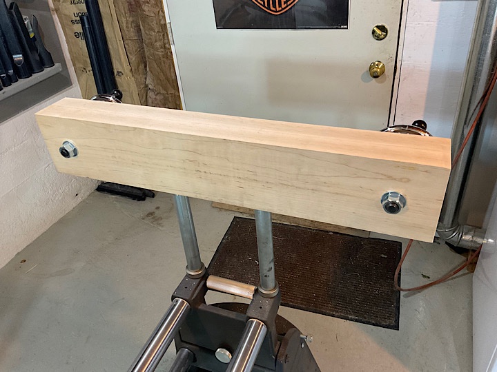

Here is the beginning of my attempt at building a Mononoke Vise.
I’m using Maple (available in my area) and it’s 5 3/4w x 30l x 1 3/4 d. The hardware arrived today so installing that is the next step. My current thinking/plan is not to add a bevel to the front jaw (I don’t do a lot of hand work so I’ll leave it square, if needed I can add one in the future.
So my question is about bench dogs. I’d want to add some and would like to solicit input on what to do. Things like what type / kind / quantity / size etc. I don’t have any in my workbench and admit that I’m a noob on the subject. So any ideas, suggestions & experiences would be appreciated.
Thanks…. Steve

Hardware installed.
But I’m going to try and add a modification. I’m building a 30”l x 11”w “bench with dog holes” that I will be able to attach & remove to the rear fixed jaw using these.
https://www.amazon.com/dp/B0DPXHN128?r ... asin_title
They are rated to 180lbs, and I can also use the table and other Shopsmith attachments for additional support if needed.
That way I can use the vise, or as an assembly/ work table. (More pictures and progress to come.

Some progress. Brackets arrived today, one is bad, doesn’t have mounting slots so I’ve got replacements comming. But was able to get it rough mounted. So now it’s on to drilling some bench dog holes, sanding / cleanup, & finish.
With the work top removed
With the work top folded

Moxon Vise / Mini Workbench complete. I decided on Veritas Prairie Dogs for the jaws with some aluminum (in removable top) ones for added flexibility. I’m real happy with the way it came out. I can see having a small height adjustable work bench will be a great addition to the shop.
Thanks again Cheechako, for the idea & inspiration….
Front views with additional top attached
Side view with top dropped down
Front view with top removed
Rear view with top removed.
