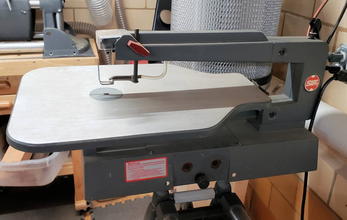

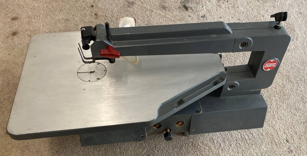

It depends on which table it has. There were two different Tables for the gray Model 555220 Scroll Saw. The early Table used an insert (P/N 515196) similar, but not the same, as the Cast Iron Table Bandsaw. The later Table used a very similar insert (P/N 516061) but different in the opening for the blade then the Aluminum Table Bandsaw Insert (P/N 516173). The Insert from the Aluminum Table Bandsaw will fit the later Scroll Saw Table.
This is the early Table gray Scroll Saw.
_ .
This is the later Table gray Scroll Saw.
_
_ .
_
