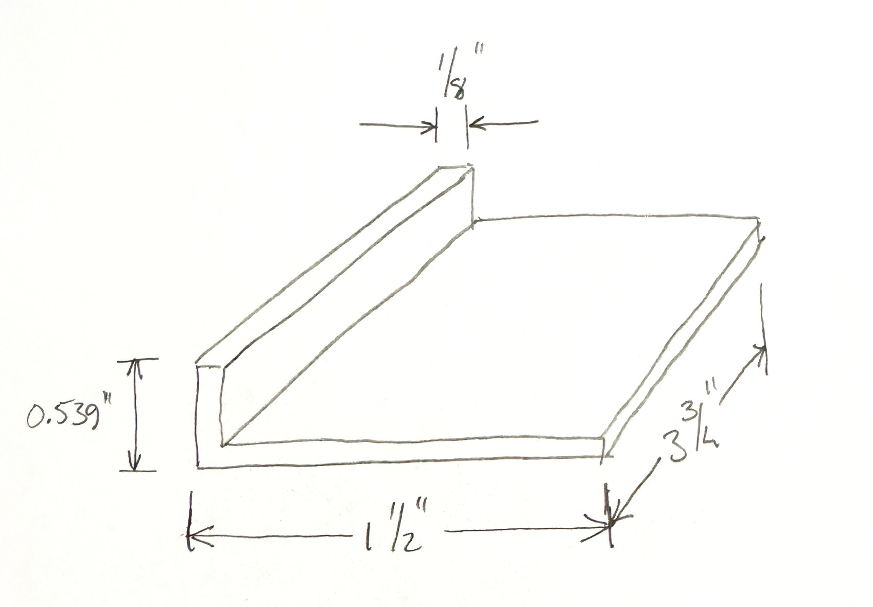

As RonKlein said you will want the Alignment Gauge for setting the 520 Fence Rails. Sorry I don't currently have a picture of it.

Quick sketch of the gauge(s -- there are two)chapmanruss wrote: ↑Sun Jun 22, 2025 12:42 pm
It appears to be milled from 1/8" thick aluminum angle. The 3-3/4" length is unimportant -- longer would be better.
