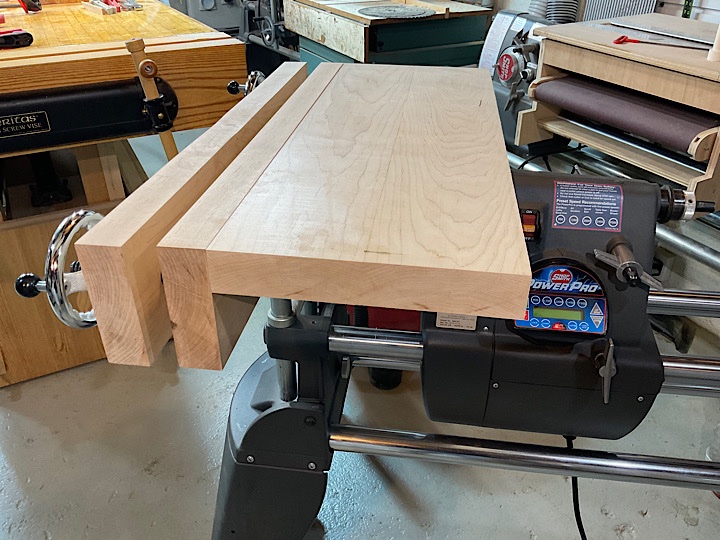

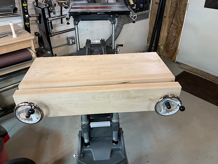

Here is the beginning of my attempt at building a Mononoke Vise.
I’m using Maple (available in my area) and it’s 5 3/4w x 30l x 1 3/4 d. The hardware arrived today so installing that is the next step. My current thinking/plan is not to add a bevel to the front jaw (I don’t do a lot of hand work so I’ll leave it square, if needed I can add one in the future.

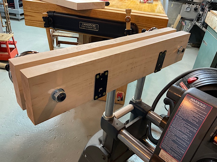

Hardware installed.
But I’m going to try and add a modification. I’m building a 30”l x 11”w “bench with dog holes” that I will be able to attach & remove to the rear fixed jaw using these.
https://www.amazon.com/dp/B0DPXHN128?r ... asin_title
They are rated to 180lbs, and I can also use the table and other Shopsmith attachments for additional support if needed.
That way I can use the vise, or as an assembly/ work table. (More pictures and progress to come.

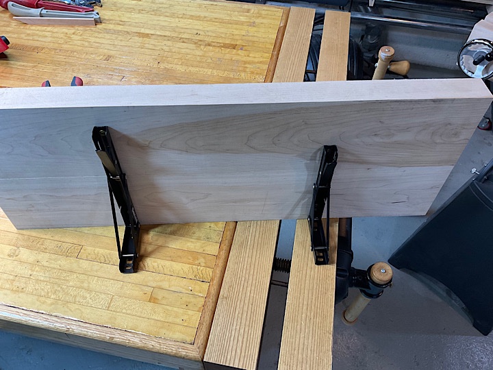

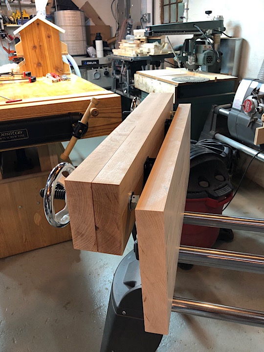

Some progress. Brackets arrived today, one is bad, doesn’t have mounting slots so I’ve got replacements comming. But was able to get it rough mounted. So now it’s on to drilling some bench dog holes, sanding / cleanup, & finish.
With the work top removed
With the work top folded
