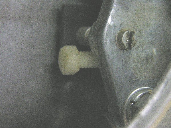

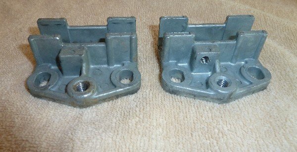

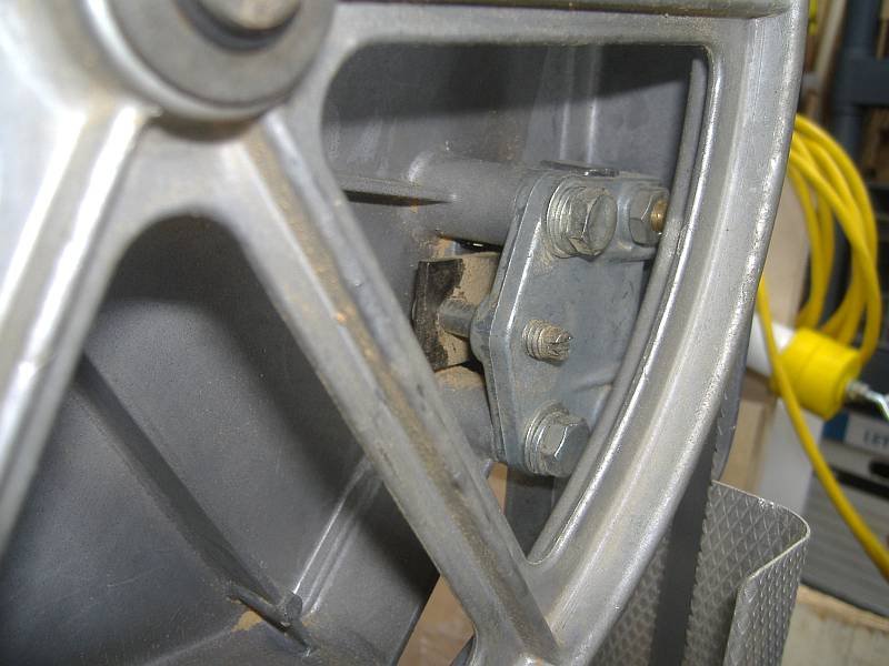

Since you are doing an overhaul of your Bandsaw I have an additional recommendation for you. If yours is an older Bandsaw it may not have the Nylon Bolt in the Guide Bracket for the Upper Guide Column. The picture below shows the Nylon Bolt in place on the bracket mounted in the Bandsaw.
_ .
Below is an older Bandsaw without the Nylon Bolt in the Guide Bracket.
_ .
Adding the Nylon Bolt to an older bracket is a fairly easy job but does require a tap and drill bit to make the threaded hole in the Bracket. Its location is shown in the picture below on the right.
_ .
The Nylon Bolt should extend past the edge of the bracket as it does in the top picture. A Hex Head Nylon Bolt is easier to adjust than a Slotted Head Screw in this case.
Adding or having the Nylon Bolt makes adjusting the Column in the Bracket easier by adding some pressure to the side of the Column keeping it better in line side to side.
Adjusting the Column in the Bracket is the most difficult part of the alignment of the Bandsaw. Having the right amount of pressure against the Column, side to side and front to back makes it easier to adjust it so the Upper Guide Block at the end of the Column stays in the proper position relative to the back of the Blade as the Guide Block is raised and lowered. Hopefully that make sense. This alignment should be done as you finish your Bandsaw overhaul regardless of having or not having or adding the Nylon Bolt.
