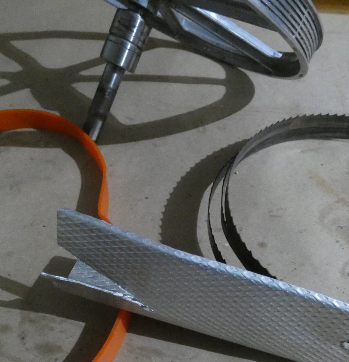

Picture shows the crack in the blade guard and the lower wheel as I had to remove the wheel to get the tire that was wrapped all around the backside when it came off. The upper wheel was easy to clean as the adhesive came off almost entirely in one piece. On the lower wheel I used bit of acetone and small brass brush took probably an hour to get it cleaned. To install the orange tires, I used 4 zip ties to hold the tire on as I worked my around. for the last 6" or so I used a wooden dowel and bit of laundry detergent to stretch the tire on. Then cut the zip ties off, took couple of tries and 20 minutes or so for each wheel. I have ordered a used lower wheel from eBay seller and two more orange tires from a 3rd party. If those orange tires fail, then I will probably try the blue ones as suggested. The original blade had two pretty good crimps in it, so guessing that the blade came off and cut thru the blade guard. All of the bearings seem fine. Also, I am wondering how much effort it should take to move the tension arm up and down when there is no blade installed?

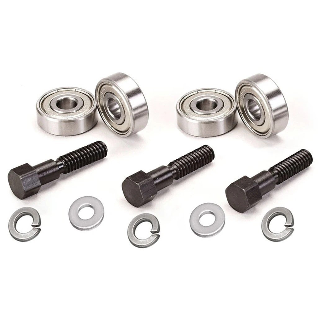

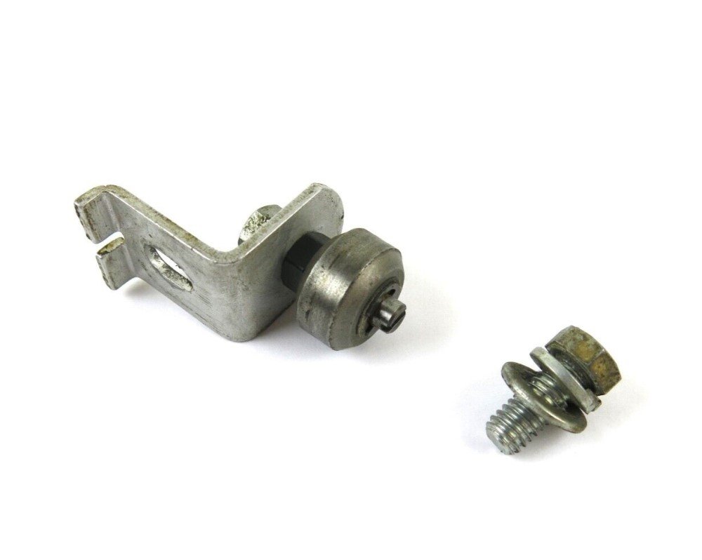

The first recommendation I would have is to upgrade the Backup Bearings in the Auto Track and the Upper & Lower Guides. Below is a picture of the older type of roller guide on the Auto Track Bracket that mounts next to the Blade Tensioner. The older type is easy to spot with the beveled sides. The original rollers were made of plastic. These are where the most annoying common noise is produced being a roller on a shaft as opposed to actual bearings like the ones included on the upgrade. They can work fine but need regular cleaning and proper lubrication.
_
Auto-Track Blade Guide Assembly V2.jpg (37.15 KiB) Viewed 41268 times
Below is a picture of the Backup Bearing Upgrade. Two of the Bearings are used side by side for the Auto Tracking and one each for the Upper and Lower Guides.
_
Bandsaw Backup Bearing Upgrade.jpg (86.12 KiB) Viewed 41268 times
