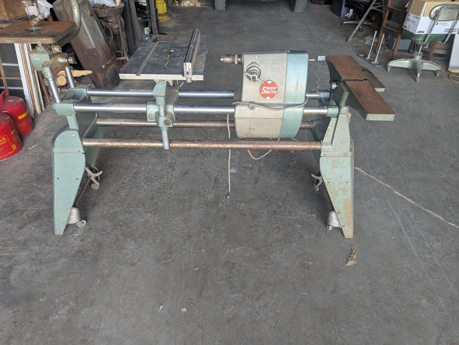

1960 Yuba Greenie Mark 5, Serial Number 362118
1960 Yuba Greenie Model 620-C Jointer, Serial Number M070521
So, this is about the fastest turnaround I've ever had on a Mark 5 restoration that needed a legitimate overhaul. I picked it up on Saturday morning of Labor Day weekend, and finished it up this past Sunday night...
And it did need some work. It unfortunately was left outside for a bit through some rain before I picked it up, resulting in a pretty good coat of rust on the usual suspects (jointer, drill chuck, bench/way tubes). Worse yet was the water accumulation in the headstock(!) that became evident as the rusty water poured out in the back of my car when I turned it on its side to load it up...
All that motivated me to act more quickly than usual to break it down to begin the cleanup. Also given that this was a freebie pickup, where I was personally only interested in the included Magna American Goldie bandsaw (that part is staying with me...), I really wanted to get this turned around for a new user as quickly as possible. Luckily, the paint was passable - sure a little scuffed up on the bench legs, but I think Magna/Yuba had really figured out how to get their paint to adhere better to the aluminum castings, so I didn't have to do any painting! The porkchop on the speed changing mechanism also had a little life left in it, and generally the headstock innards only needed degreasing/cleaning and lubrication.
As this was the first Yuba Greenie I'd ever seen in-person, it was interesting to view a few of the peculiar features of this one:
- The drive sleeve was still nice, machined metal, as opposed to the cheaper nylon spline sleeve that appeared in Goldies soon after this.
- Yuba had started looking for cost-cutting measures, and introduced the two-piece main table with the extruded fence track (I'm a much bigger fan of the earlier Mark 5 one-piece cast aluminum table...) - as well as the secondary saw blade slot cut in the table.
- This one had funny bench tubes that were way tubes with an insert to extend them to bench tube length, although they hadn't yet modified the bench end castings for these smaller OD bench tubes.

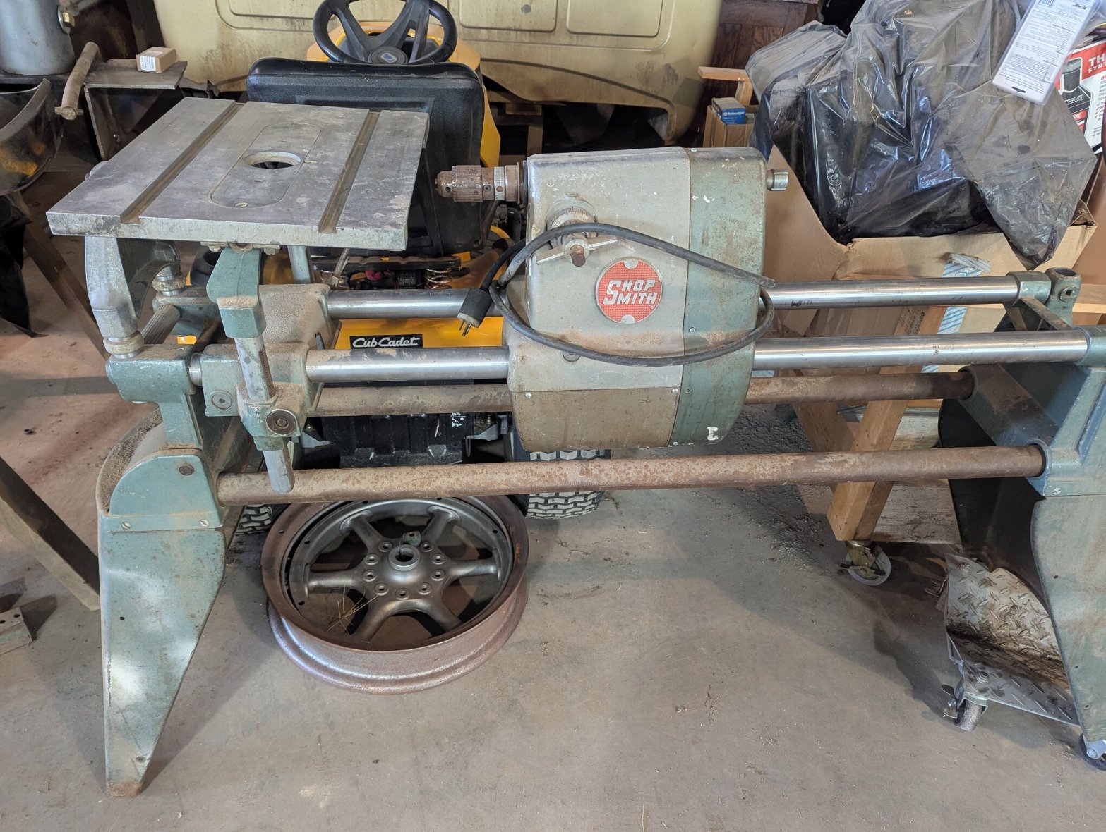

OK, since the forum has been down, I have added the following two machines to my collection. They are waiting in line to be restored later this year after I get a couple other projects done. The first one is serial #273446, the second one is missing the serial #, but I have purchased a new vent plate for it, so it will become serial# 266645.
1954 Shopsmith Mark 5 500 Greenie serial# 273446
1961 Shopsmith Mark 5 500 Goldie serial# 369690
1980 Shopsmith Mark 5 500 Grey Ghost serial# 53313
1955 Jointer serial# 32449
1957 Jigsaw serial# 70888
1983 Planer serial# 07879
1981 Bandsaw 505641 serial# 47391
1994 Jointer 555483 serial# 01-01-94
Belt Sander Serial# 25625

Nice additions Allen. You found a different Vent/Serial Number Plate than the one I was looking at. That puts its new identity at May of 1954. The other one is from July. They should be very similar unless upgrades have been done to either or both of them. I look forward to seeing them finished and how the custom paint you have looks compared to the original color.
