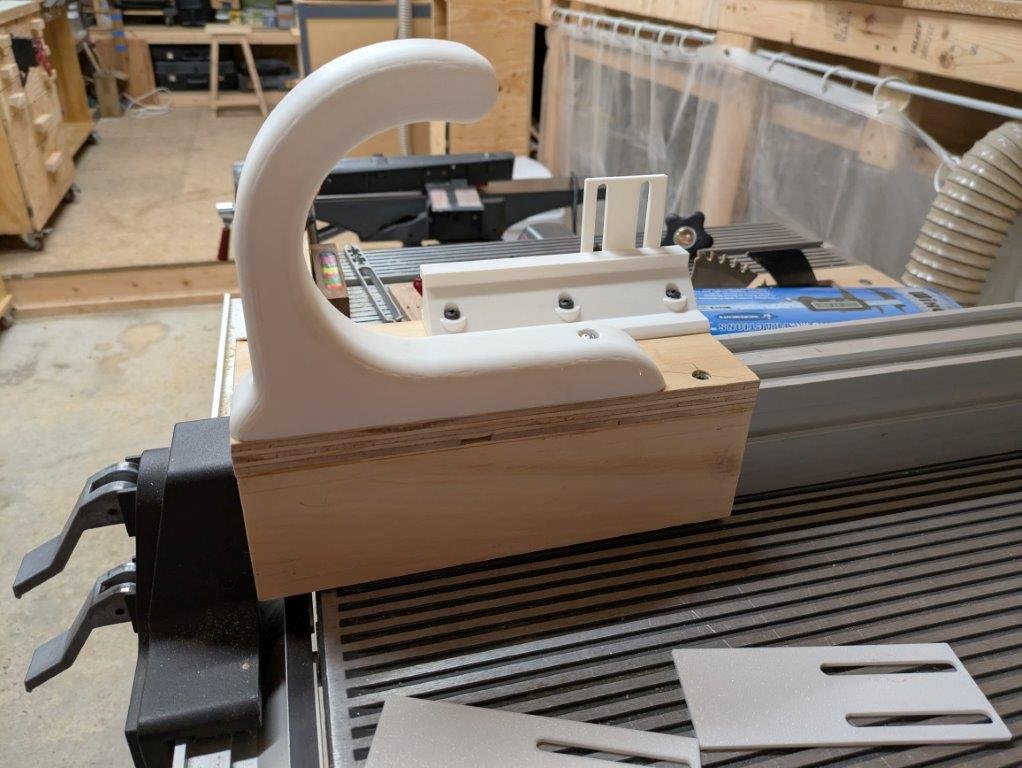

Just curious, are you planning to rip multiple 3/8 pieces from this piece of stock or just ripping it down by 3/8 and the cut off is waste? In your second picture I would move the featherboard back to be inline with front edge of the stock. Seems like that last long finger would push the cutoff into the blade.
If you’re making a bunch of 3/8 pieces I would setup the fence for a 3/8 cut and use the fence straddler because I don’t want to move the fence every time for the next cut.

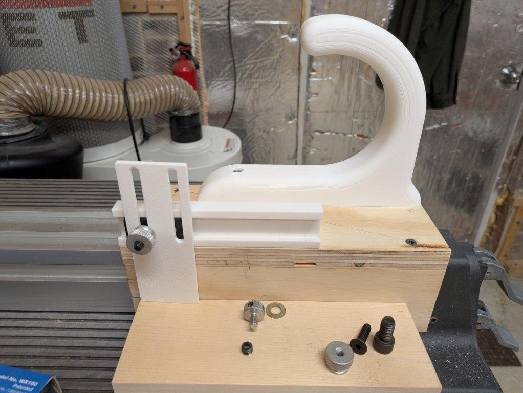

Here is the approach I am going for. Kind of a Frankenstein of the various jigs shown on this thread.
It uses a fence-straddler approach with top mounted handle. The straddler is 3/4 ply.
The hold down for the front of the board is a printed t-slot adapter using components I had laying about.
All the white parts, my son designed and printed for me with very little input...too bad he's headed off to college this week
The slotted plate needs one further redesign today and then I will give it a try.
Thanks everyone for you input !

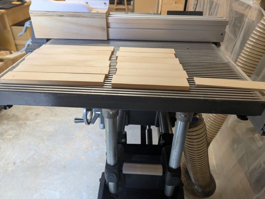

It worked well, here is some frame stock I started with.
Upon review-I think more important than the jig design was the idea of having the narrow part of the cut next to the fence. This reduces the tendency
for the piece to draw away from the fence.
b
