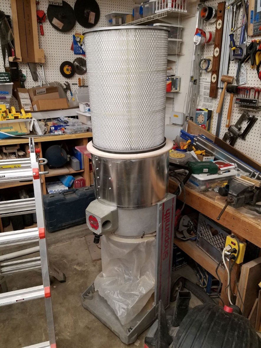

HopefulSSer wrote: Wed Jan 21, 2026 11:27 am
I don't own a SS dust collector so I have no personal experience. But IMO, just from looking at pictures, the little tiny filter bag on top is woefully inadequate. It needs MUCH more surface area, especially if the bag is 1- or 2-micron. A bag double or treble the height would be better, a pleated filter would be much better still. That little bag has got to be a big contributor to reduced airflow.
I don't see a micron rating spec for the filtering on the SS web page. To me that is a critical data point.
I used a Stumpy Nubs technique to replace my filter with a Wynn Environmental canister. https://www.youtube.com/watch?v=Ru0owrbfoLo If I remember right it's MERV15 rated. https://wynnenv.com/products-page/woodw ... ridge-kit/

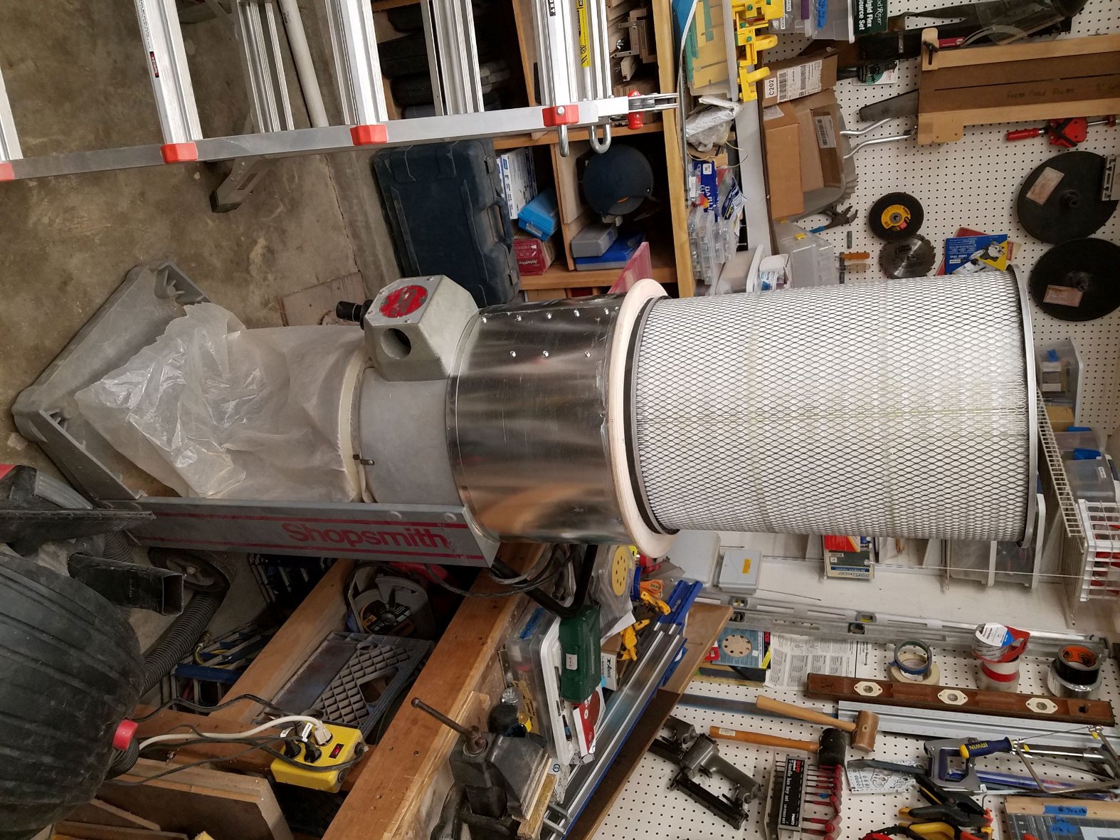

(Can't figure out how to post this picture in the right direction. I saved the original in various rotations and they all loaded on their side.)

hfmann wrote: Wed Jan 21, 2026 1:44 pm
I used a Stumpy Nubs technique to replace my filter with a Wynn Environmental canister. If I remember right it's MERV15 rated.
I removed the 30(!) micron bag from my Delta DC and installed a pleated filter. The bag filtered out only rocks, cigarette butts, and dead birds....

ok JPG. How'd you do that?
hal
Re: clogged DC6000
hfmann wrote: Wed Jan 21, 2026 6:53 pm ok JPG. How'd you do that?
hal
Cameras/smart phones . . . store an orientation code of how the device was held when pix was taken.
The forum software IGNORES that code.
IIRC the forum software assumes a raw dump of the pix as the device 'sees' it.
So external help is needed (Irfanview. . .) to rotate the data hence the displayed orientation.

hfmann wrote: Wed Jan 21, 2026 1:44 pm I used a Stumpy Nubs technique to replace my filter with a Wynn Environmental canister. https://www.youtube.com/watch?v=Ru0owrbfoLo If I remember right it's MERV15 rated. https://wynnenv.com/products-page/woodw ... ridge-kit/
It is a nice looking HEPA filter conversion. Well done. Yeah, I suspect you are getting slightly higher airflow with your DC-6000 than Dusty, based on your anemometer measurements, due to less restriction with that Wynn HEPA filter. Dusty was using a Shopsmith filter hood, a 24" I believe.

JPG wrote: Wed Jan 21, 2026 7:30 pm
Thanks JPG. I'll give that a shot the next time.
