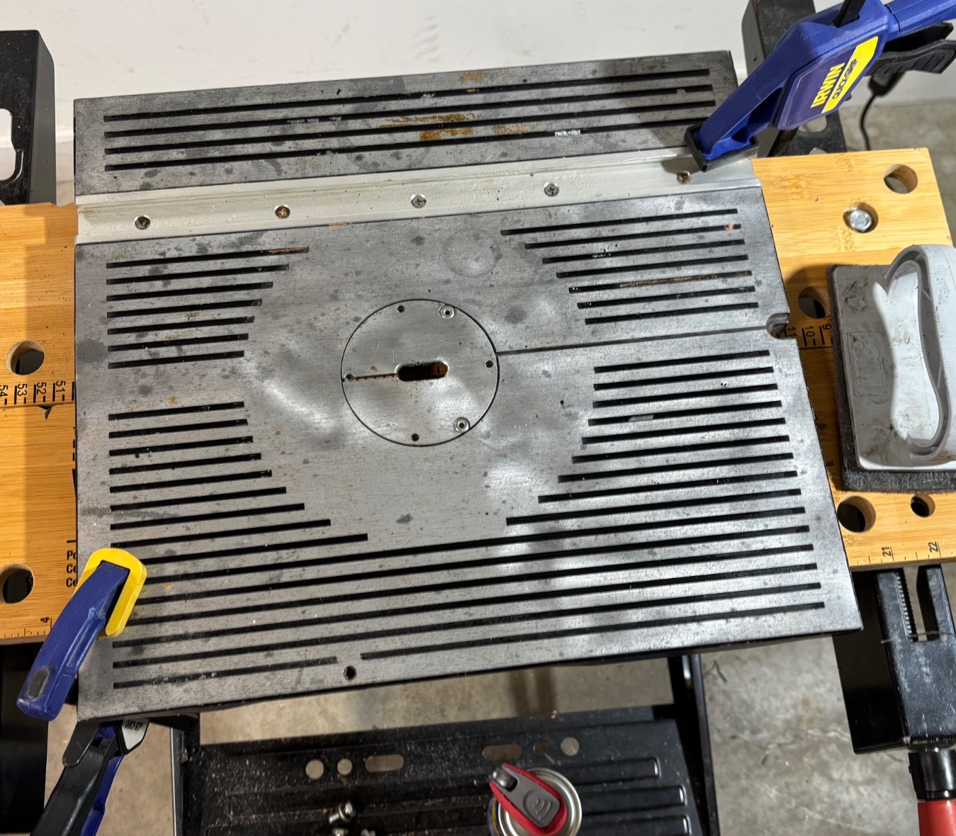

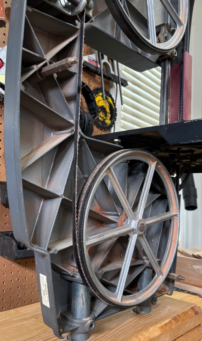

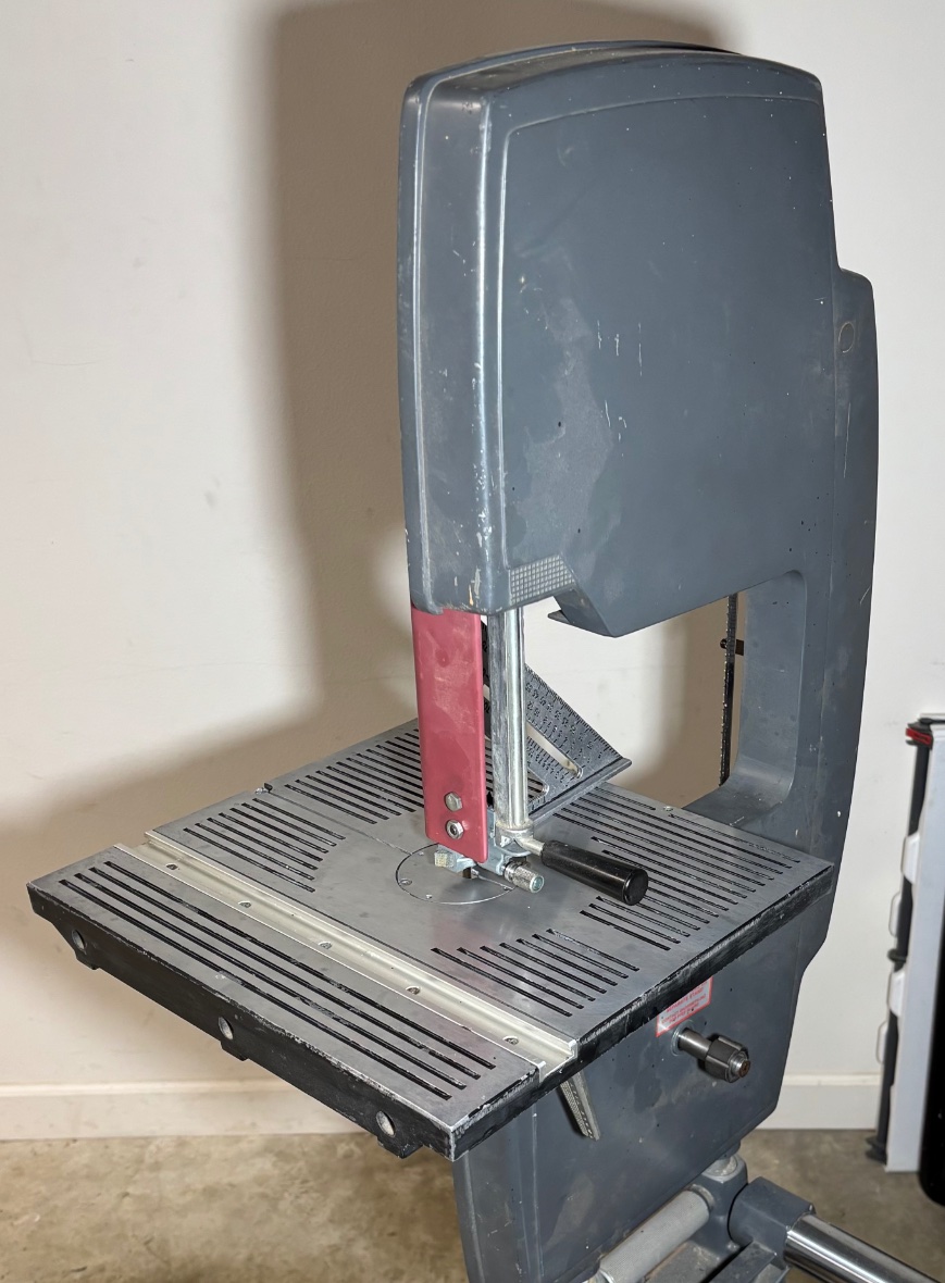

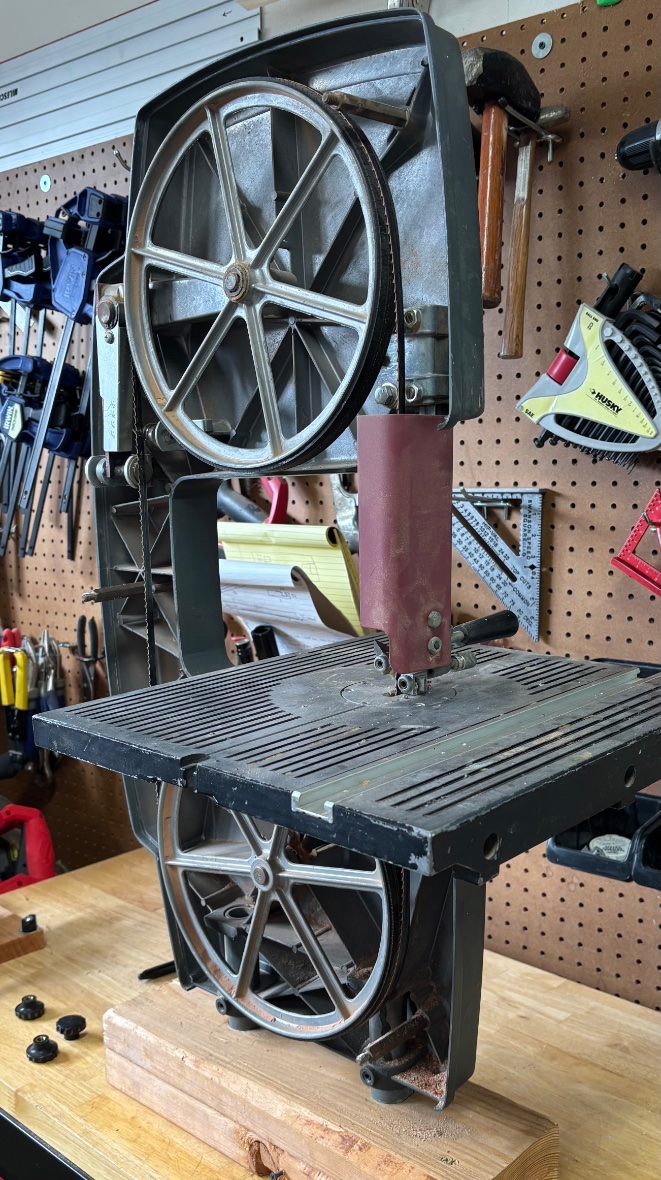

Notice the beat up table and worse tires.
- IMG_7133.jpeg (372.73 KiB) Viewed 17591 times
- IMG_7132.jpeg (292.27 KiB) Viewed 17591 times
- IMG_7131.jpeg (307.44 KiB) Viewed 17591 times

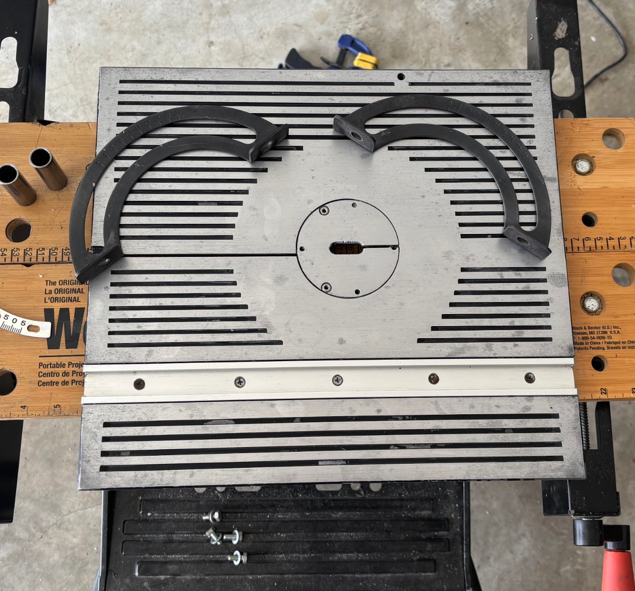

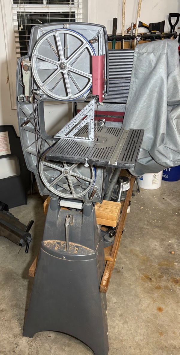

Table refinishing
- IMG_7296.jpeg (518.59 KiB) Viewed 17591 times
- IMG_7278.jpeg (588.76 KiB) Viewed 17591 times

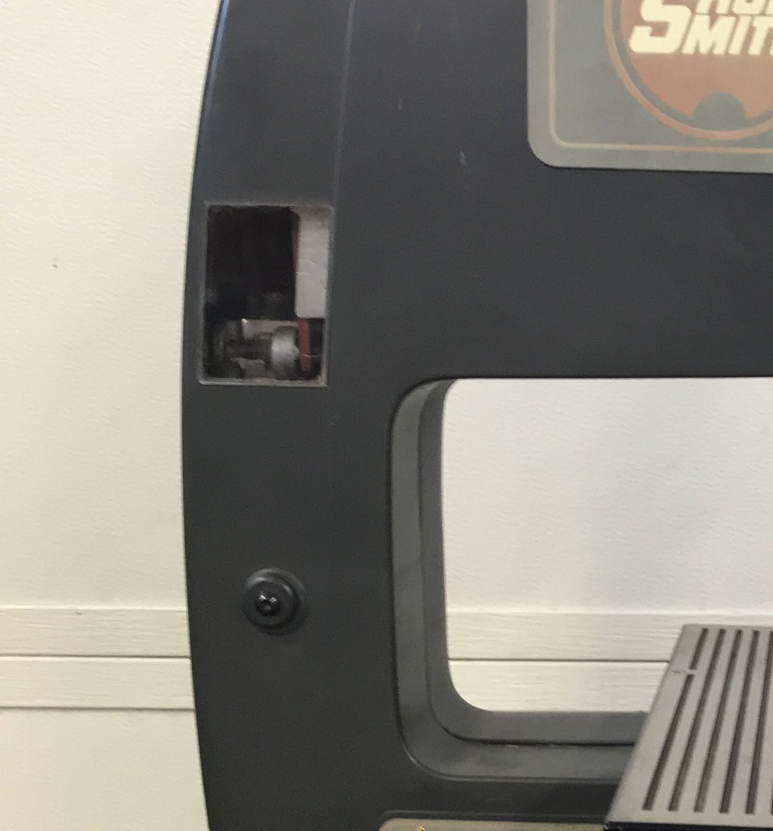

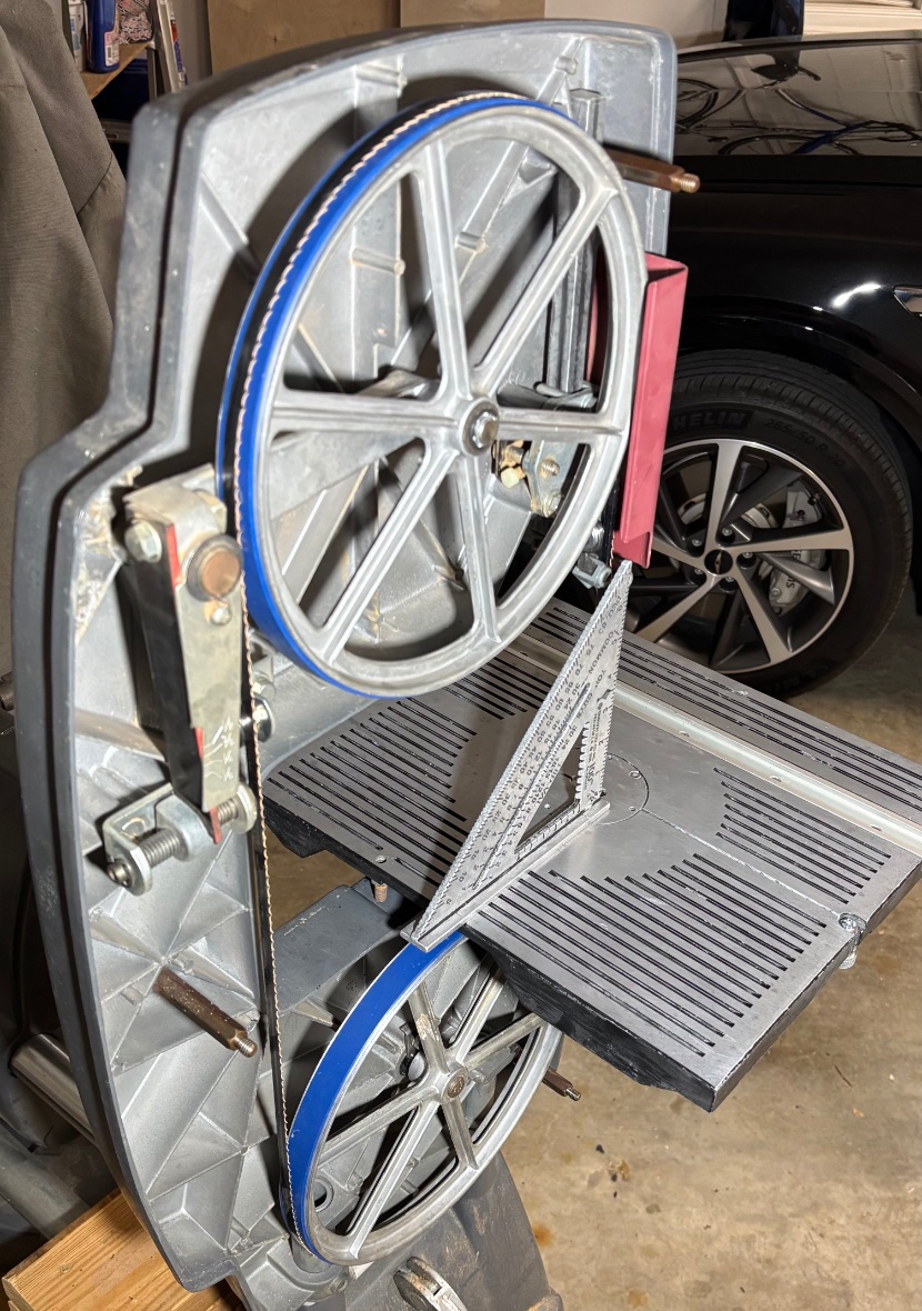

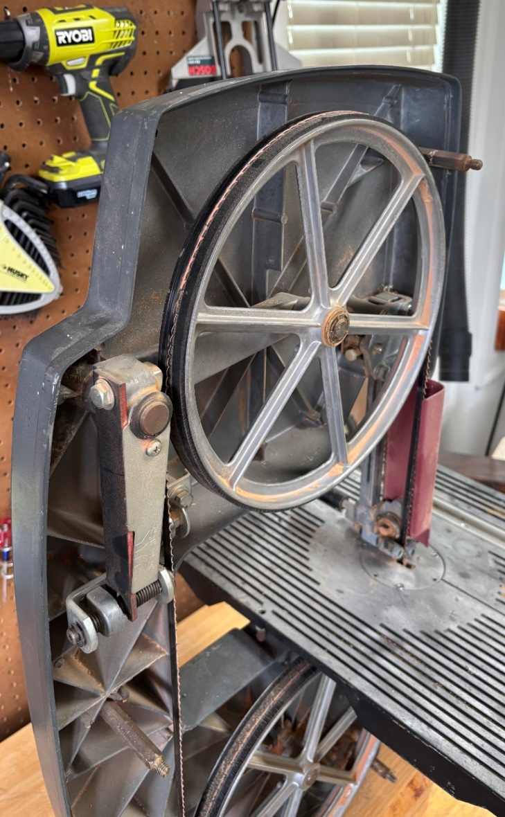

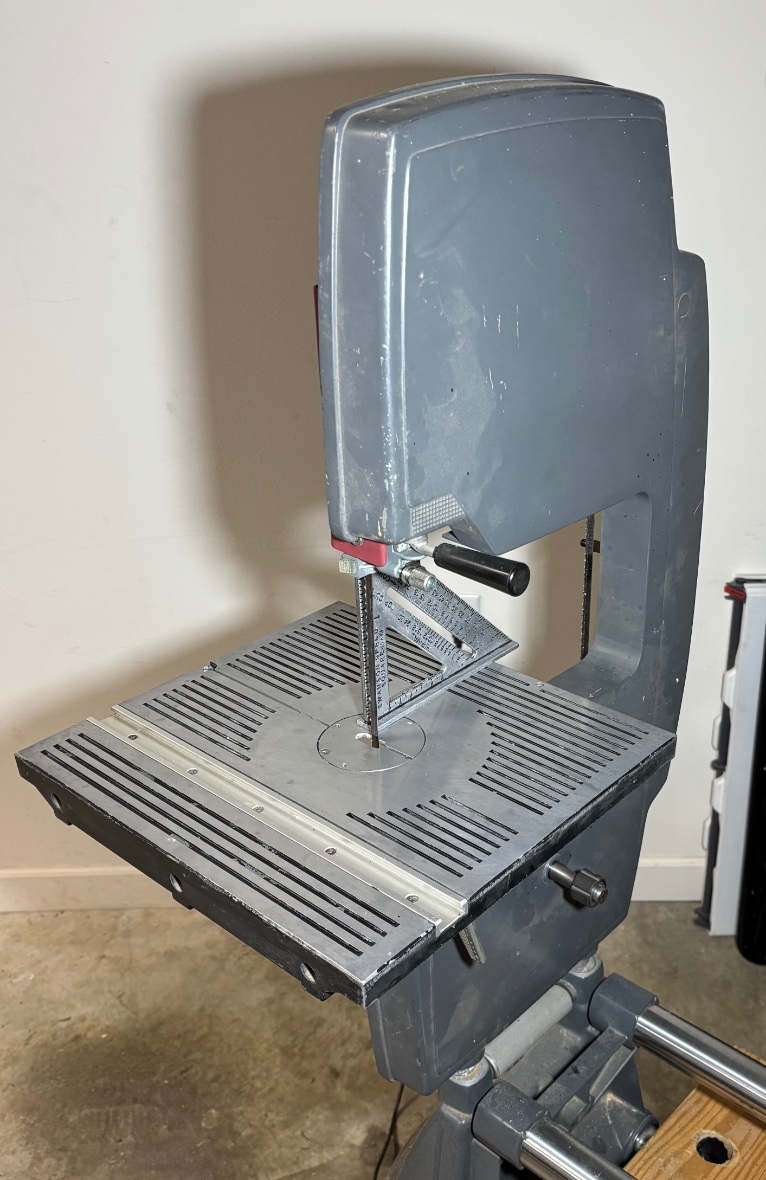

Finished repairs
- I drilled a hole to adjust the tension without opening the case.
- IMG_7303.jpeg (551.25 KiB) Viewed 17591 times
- IMG_7302.jpeg (249.92 KiB) Viewed 17591 times
- IMG_7300.jpeg (397.6 KiB) Viewed 17591 times
- IMG_7299.jpeg (267.81 KiB) Viewed 17591 times
- IMG_7301.jpeg (252.46 KiB) Viewed 17591 times

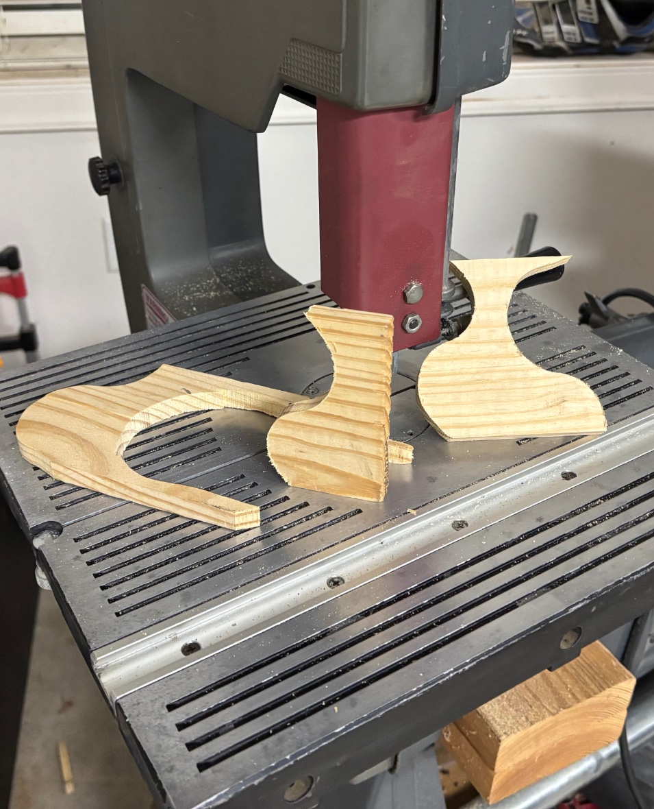

First cut….like butter!

I see you added an access hole to adjust the tension of the blade like newer Bandsaw Covers have. It would also be useful to add the "window" (shown below) to be able to see the Tension Gauge. Owners have added the OEM part called the Bandsaw Clear Plastic Window for Bandsaw Cover SKU 522217 for $15.95 from Shopsmith. It is currently listed as out of stock but should be available in the near future. They report it as a fairly simple cut out of the cover to the size of the window. Something to think about to for your Bandsaw to be able to have the Blade Tension correctly set without removing the cover.
_
_

I thought about that. I have some acrylic but I wasn’t sure how to cut the cover neatly to create a “window frame.” Any ideas on that?

I have not cut an opening for installing the window in an existing cover. The picture I posted is of a 2006 Bandsaw which already has the window. Others have done it with success. For the OEM Window it clips into the opening but for a homemade window you would have to plan for some kind of attachment.

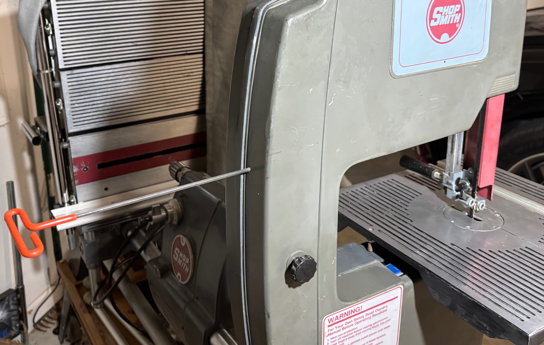

Noticed the square in thy pictures. Have you held the square against the back of the blade?
DO NOT BE ALARMED if is is NOT square. The blade should tilt back about 2.5 (IIRC) degrees due to the auto tracking scheme.

Thanks. I was actually squaring it L/R and just left it on the table for the pictures. But I appreciate the tip on the front/back alignment.JPG wrote: Fri Mar 06, 2026 11:09 pm Noticed the square in thy pictures. Have you held the square against the back of the blade?
