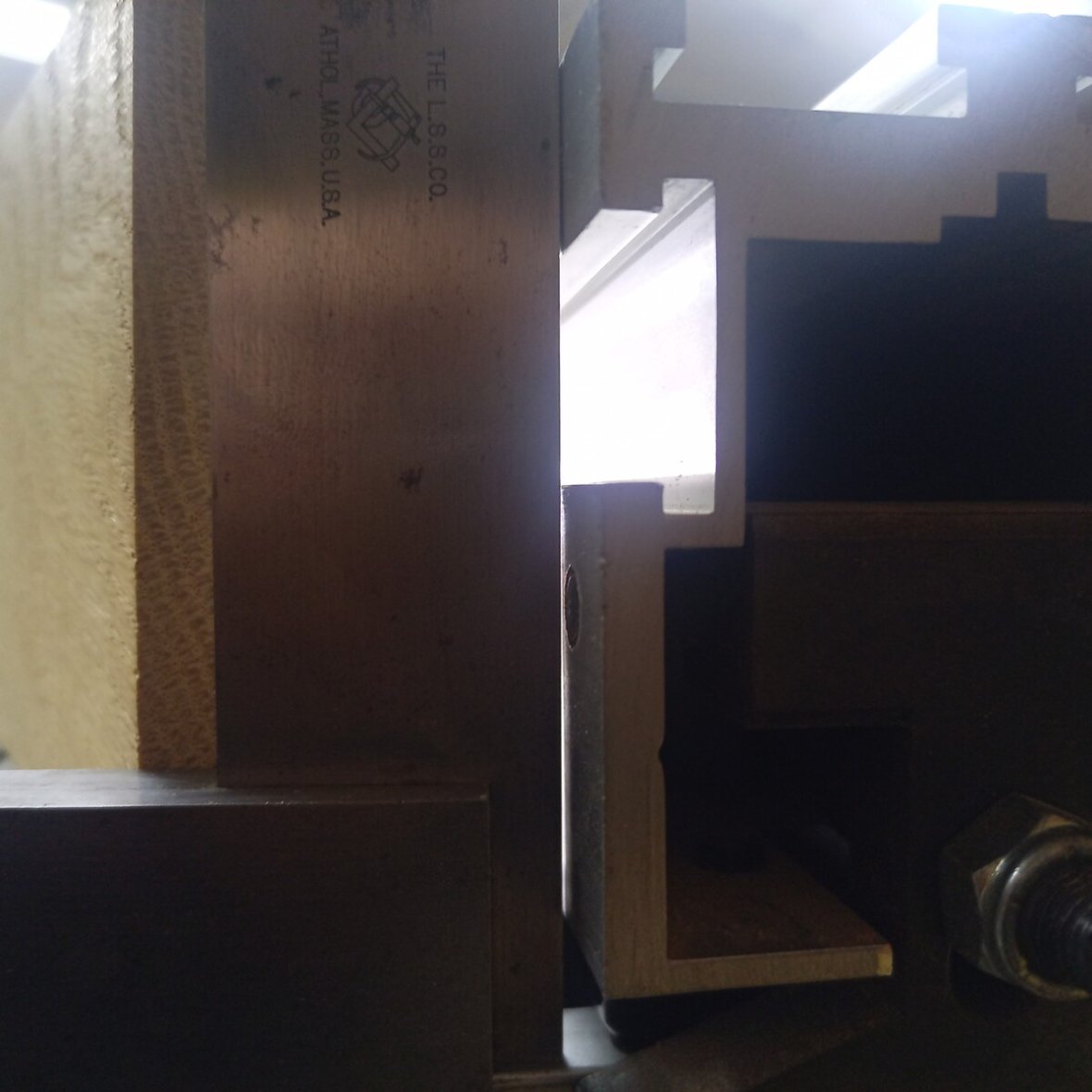

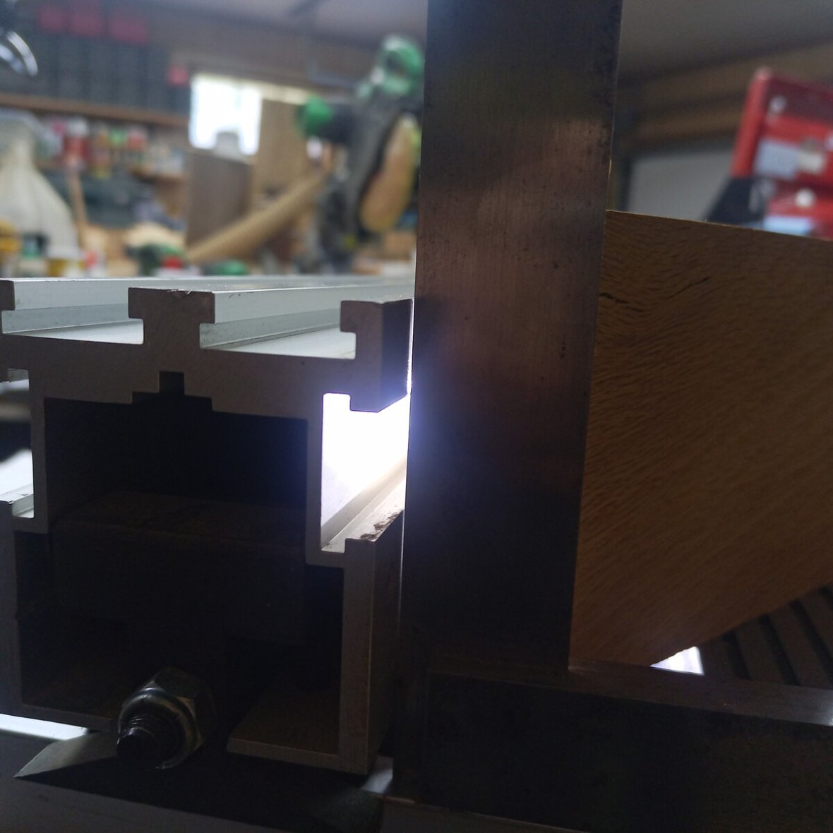

The fence should be square to the mounting rails. Measuring to the rear rail is straightforward. Measuring to the front rail is less so, especially if you have the direct readout indicator on the bottom of the fence. I don't have a great square for that, a Starrett 20 like you have in the first picture is close if you put the base on the fence you can eyeball a small gap between the blade and the highest part of the rail. A larger #20 might get you there, I was using a 4-1/2" one. My thinking here is that this would be informative, identify which end(s), if any, are problematic.

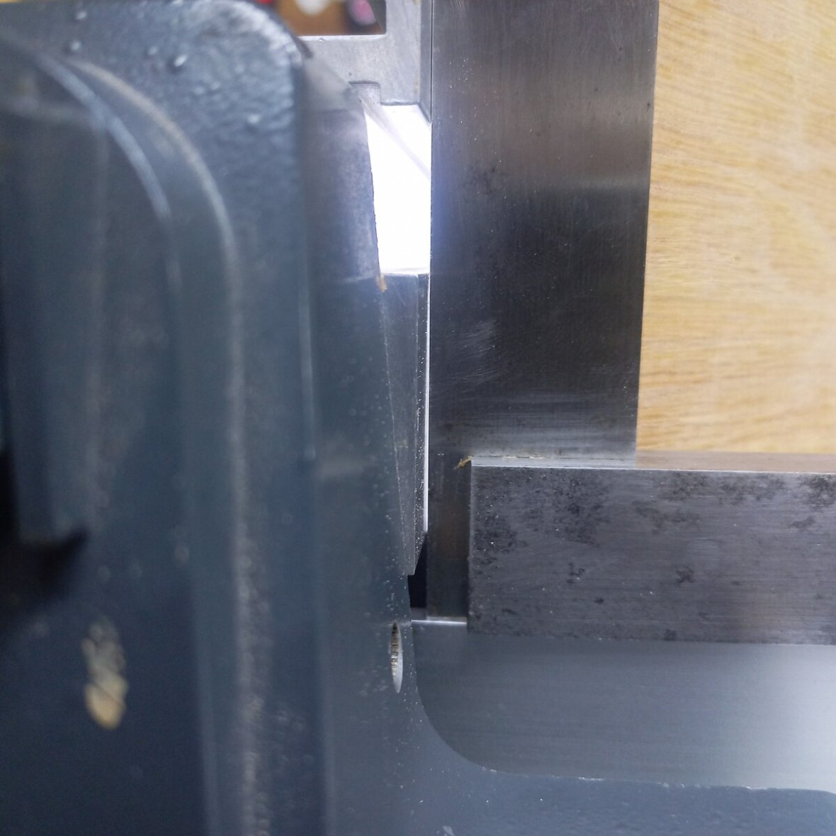

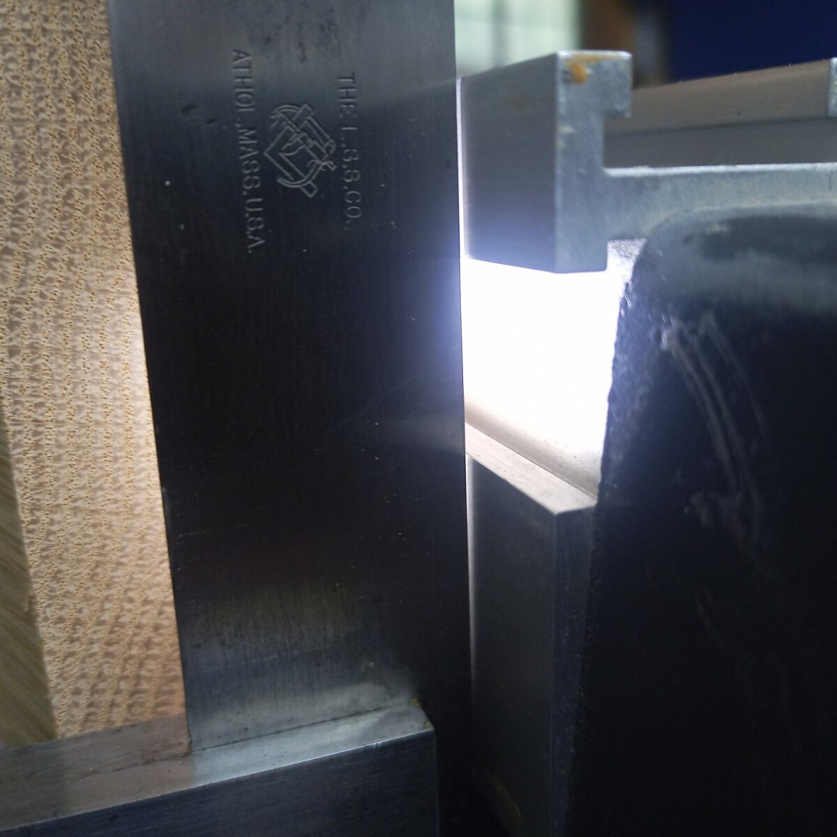

Hopefully, this is what you are talking about. The fence is locked down to the table, and the square is sitting on top of the rail. The photos aren't great, but these are hard shots to capture. I am beginning to think the extrusion has a slight twist end bend.

So it is out of square at both ends, at least when mounted. With the fence upside down, can you see if the hard plastic pad at the outfeed end is square to the extrusion? Then, the same idea on the infeed end to see it the fence mounting surface, two rubber(?) pads, are square to the extrusion. (I haven't worked out how to do this, need something like maybe a large steel parallel in combination with a square.(?)) I think I would try a combination square with two heads, then an additional square, but we don't all have the same stuff. Are the rubber mounting pads in good shape?

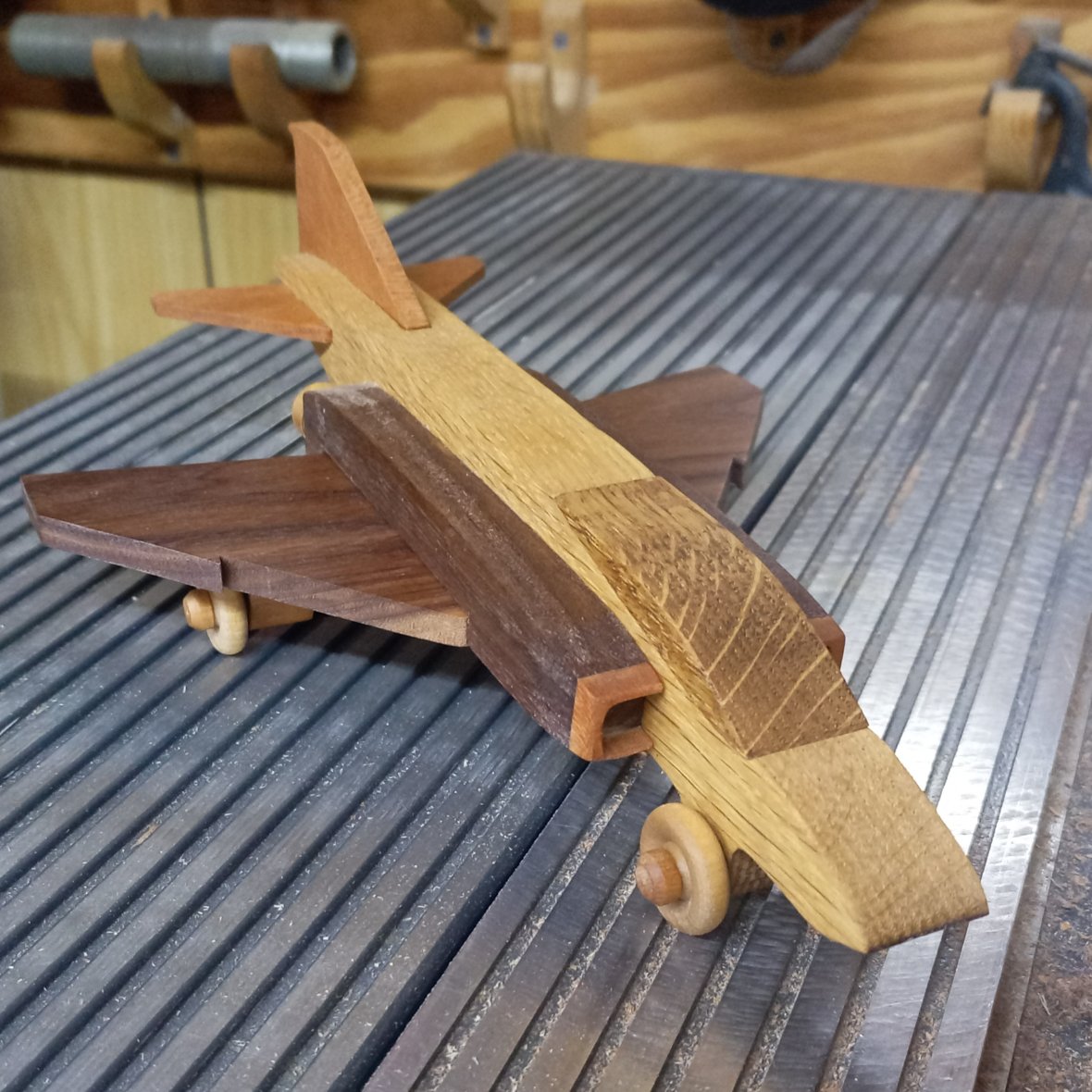

I need to cut two slots at the ends of a piece of hardwood, centered and parallel to the sides. I made a jig to do this before I discovered the fence was not square to the table. I make the cut in two passes, turning the wood over for the second pass to be sure it is centered. I was hoping to get precise, clean cuts with parallel sides. When using the fence, I get a tapered slot.
Here is what I am making:
Wooden Toy F-4 Phantom Fighter Jet
20260331-070620 009 4480730894 F-4 Phantom Fighter Jet Airplane.jpg (231.25 KiB) Viewed 16458 times
The slots are for the tail section. I have been cutting these with my scrollsaw, cutting slots in 1-3/4-inch-thick hardwood. Cutting slots with a scroll is slow, difficult, and requires sanding and filing to fit.
