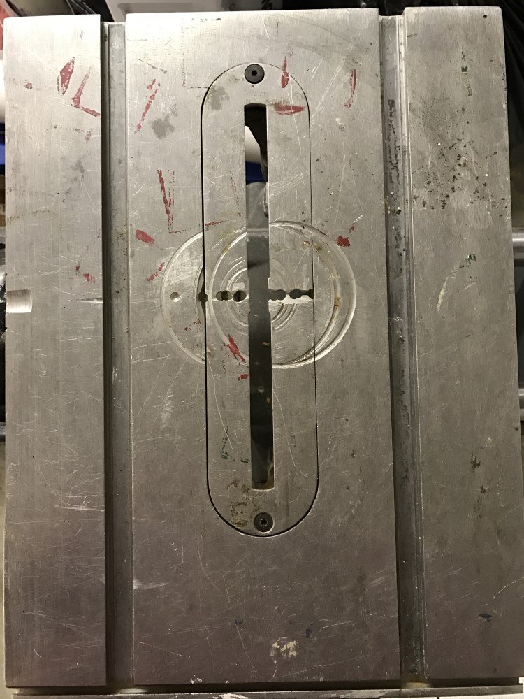

A word of caution is always protect the Main Table from the Drill Bits contacting it. Don't let your table end up looking like the one below.
_ .
That Main Table is from a 1982 Mark V I restored which the Table and Insert had to be replaced.
_ .
