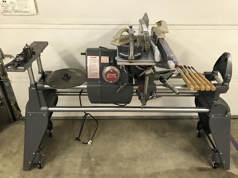

For reference, below is a Mark V 500 With its original accessories plus Lathe Chisels.
_ .

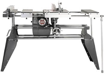

Below is a Mark V 510.
_ .
Below is a Mark V 520.
_
_ .
_ .
_
