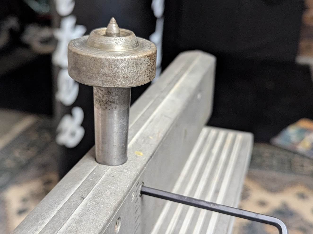

So after thinking about the issues that JPG and the following comments brought up, I set the cup center back into the fence and tried to measure the wobble when the center was loose in the hole. It looks like about 1/8 of an inch or a bit more in all directions. With the set screw tightened, the cup center is indeed pulled off plumb. The set screw bears on the the bottom 1/8 inch or so of the center and when tightened pulls the tip of the pin 1/8 of an inch towards the set screw side of the fence. Without the set screw being tight using this set up would require perfectly vertical pressure along the axis of the cup center during the cut. Probably not attainable. However, with the set screw tight, variations in the direction of the downward holding force do not move the (unplumb) pin. The question then is what difference does it make if the pin is not at a perfect right angle to the table? Seems like as long as the pin is positioned in the desired center of the intended circle and does not move from that spot during the operation that it would work OK.

Well, if the center moves around 1/8" as you say ( I suspect you are correct) then the cup edge is raised up on the side away from the set screw. Does it raise up enough to not let the center pin get a good grip due to the stock bottoming out on the cup rim?IdahoEd wrote: Sun May 24, 2026 9:22 pm So after thinking about the issues that JPG and the following comments brought up, I set the cup center back into the fence and tried to measure the wobble when the center was loose in the hole. It looks like about 1/8 of an inch or a bit more in all directions. With the set screw tightened, the cup center is indeed pulled off plumb. The set screw bears on the the bottom 1/8 inch or so of the center and when tightened pulls the tip of the pin 1/8 of an inch towards the set screw side of the fence. Without the set screw being tight using this set up would require perfectly vertical pressure along the axis of the cup center during the cut. Probably not attainable. However, with the set screw tight, variations in the direction of the downward holding force do not move the (unplumb) pin. The question then is what difference does it make if the pin is not at a perfect right angle to the table? Seems like as long as the pin is positioned in the desired center of the intended circle and does not move from that spot during the operation that it would work OK.

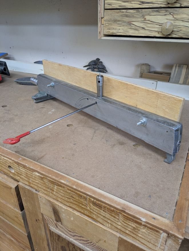

Interesting! My tailstock fits VERY snug. I don't think I'd even need a set screw with vertical pressure, but even with it it only moves ~1mm once I jam it in properly. It all feels way more secure and stable than I had imagined.

John: Good question. My first thought is that the rim of the cup center would not raise up enough to contact the workpiece unless the "dimple" made for the centering pin were needlessly deep. My second thought is that if this sort of interference were a significant issue it would have been mentioned in the chapters of PTWFE that discuss the technique. But, to be fair, I guess the only way to really know is to set it up with an actual workpiece and see if there is interference. I will try to get around to that experiment soon.
Maurice: Thanks for the picture. Very interesting to see that a live center fits so much more snug than the the cup center...I wonder why that is...maybe the MT on the live center is a different diameter?...not sure if that would really make a difference. Another experiment to try tomorrow.
