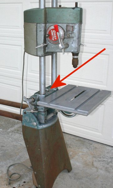

OK, I see the damage but I have a hard time invisioning that piece being broken out as a result of either the carriage slamming against the base assembly or the headstock slamming against the carriage.
The impact would all be absorbed by the metal immediately around the tubes rather than out in the middle as seen in the photo. Unless, of course, there is something to this picture that I don't see.
Example: we have had some discussion about using a small bottle jack to position the carriage when in the vertical mode. I can see this sort of damage from that sort of pressure being applied to the side wall of the carriage.

dusty wrote:OK, I see the damage but I have a hard time envisioning that piece being broken out as a result of either the carriage slamming against the base assembly or the headstock slamming against the carriage.

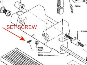

If you not thoroughly familiar with the "Greenie", I can see how you would have a hard time envisioning how the damage occurred. Here's couple pics that should help you. Notice in the 2D view of the carriage that it has an adjustable. I believe the design intent of this is to allow you to get the carriage up to the headstock at a predetermined limit. If you have to later move the carriage, you can reposition it exactly where it was previously. With the set screw OUT, it actually comes in contact with the headstock. The piece that is broken off has the set screw. If the table is off the machine when you place it in the vertical position, and the head drops.......guess where the first contact point is. Pressure = Force / Area takes it from there.:(
Your envisionment more gooder now?

mickyd wrote:If you not thoroughly familiar with the "Greenie", I can see how you would have a hard time envisioning how the damage occurred. Here's couple pics that should help you. Notice in the 2D view of the carriage that it has an adjustable. I believe the design intent of this is to allow you to get the carriage up to the headstock at a predetermined limit. If you have to later move the carriage, you can reposition it exactly where it was previously. With the set screw OUT, it actually comes in contact with the headstock. The piece that is broken off has the set screw. If the table is off the machine when you place it in the vertical position, and the head drops.......guess where the first contact point is. Pressure = Force / Area takes it from there.:(

Yup, I can see it now. All of the impact force is applied to the set screw and transferred directly to the casting that is the carriage. Thank you for your explanation. I have used a greenie but not enough to be well aware of issues such as this.
I think I would eliminate the set screw and utilize something similar to the carriage stop ring even if I had to devise one of the correct dimension.
I assume the standard carriage stop ring doesn't do the trick or all of you guys with greenie's and goldie's would have already installed them.
