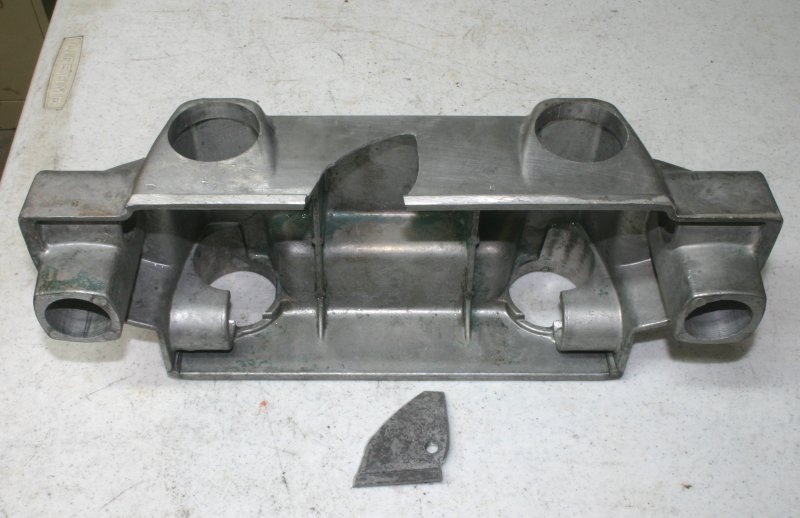

I just can't picture what the damage is that your describing.
[ATTACH]3537[/ATTACH]
This is the way my Greenie came. At least the guy saved the piece. I am going to repair it using JB Weld this week. I was told the stuff is real easy to work with, it's sandable, and it's just as good as a weld job. (naturally on small type repairs)
I was hoping that the "Carriage Stop Ring" was as you described to prevent this damage from happening in the future. I would have called it "Headstop Stop Ring" since it stops the headstop, not the carriage (in my case anyway). Thanks for the info. I am going to order a couple this week.
