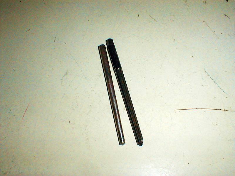

First here is a ream for using tapered pins, ream on the right pin on the left. You drill an undersized hole the ream to size. This ream is tapered but they also make reams that are straight. They are often used in metal work but can be used in wood for such things as thru dowel holes etc.

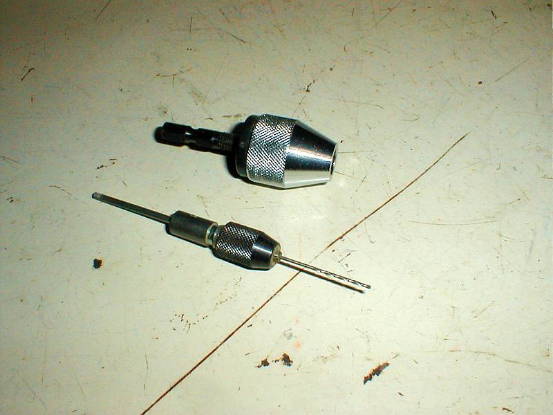

We have talked about this before but in case you missed it these are examples of chucks that allow you to use drill bits that are undersized for the chuck on the shopsmith. This is only two examples but this should give you the idea of what they look like and why you might want to own one. The chapter says the lower limit is 3/64". So any bits below that size will need something to chuck it.
[ATTACH]3700[/ATTACH]

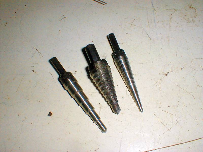

This next set of bits have steps so you can drill many size hole with just one bit. As can be seen they are limited as to the material thickness but they work well for project boxes like bud boxes and the likes. Sheet metal and even some what thicker stock can be drilled like wise. These are often sold as a pair of bits but the set I have came with 3 bits.

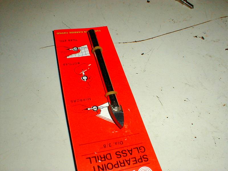

I have drilled glass two ways. One is using a tube that has a notch cut in it and you build a puddy dam with a floating abrasive in it and "drill" away. The second way is with one of these glass drills. I'll not go into details as this one pictured is a few years old and more modern versions are likely available. Just wanted you to know that a shopsmith can even drill glass.
[ATTACH]3702[/ATTACH]

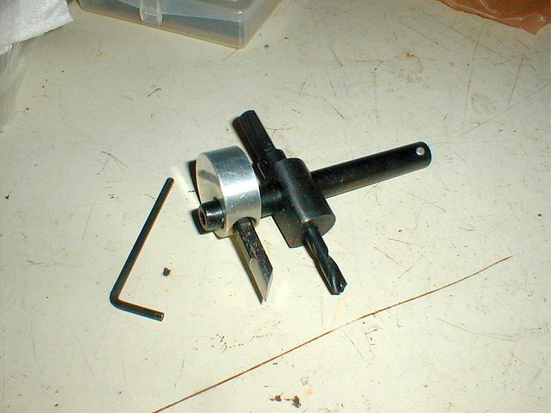

Next we have a circle cutter. This is the third one of these I've purchased, two of them didn't last long and were not so nice to use and cheap. This one was if I recall right just under $30. These come in different sizes as far as how small they will cut and how large they will cut, if I recall this cuts up to a 7" hole. Before I get any farther this will require that you have a speed reducer... top speed is about 500 rpm. Some people might call this a fly cutter you can look that up if you wish for some added education.
These have replacement blades and the blade also reverses so you can get set sized hole in material or have a cut out that is sized. Confused? The cutter has one face that is straight and leaves a straight wall where it is cutting, the other part of the cutter has an angle to it and leaves a that pattern at the end of the cut. If you can't picture that leave a message and I post a picture of how that looks.

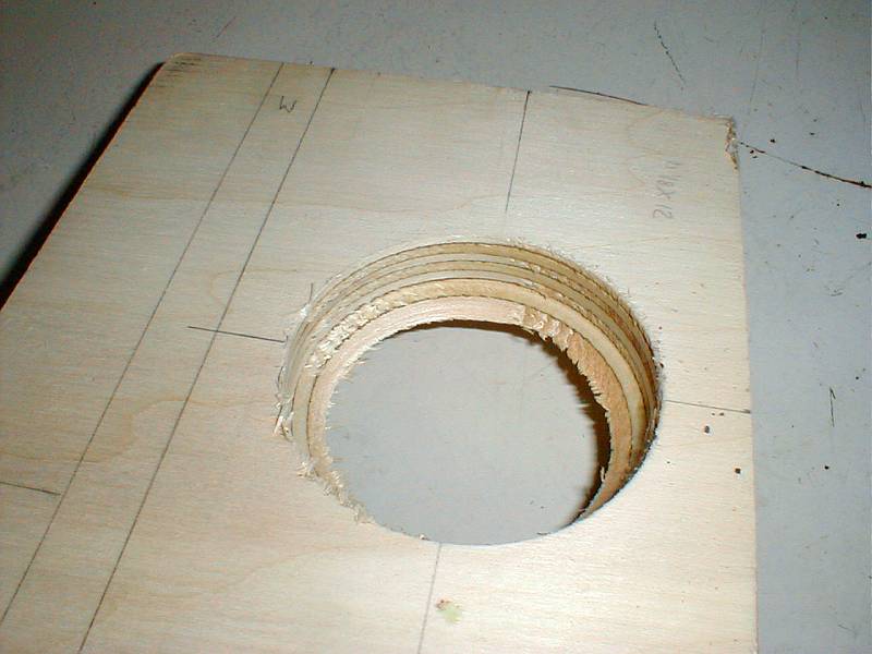

After thinking of it I thought I better post a picture of what the hole looks like after the circle cutter makes a cut. Note that the part that is removed is the good piece and what is pictured is the scrap. Had I wanted this piece as the finished part I would have reversed the cutter.

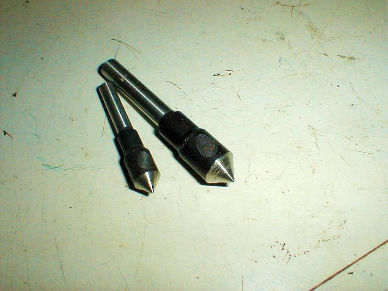

This is what I use most of the time for counter sinking. If you have viewed some of my projects that I have posted picture of you will have seen these already. For those who have not seen them, well now you have.

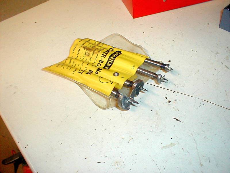

These bits are no longer made by stanley but if you see a set at a garage sale BUY them after checking to see they are in working order. They are not for hardwood and if you want to know a bit (get it... bit) more about them in there current version go to:

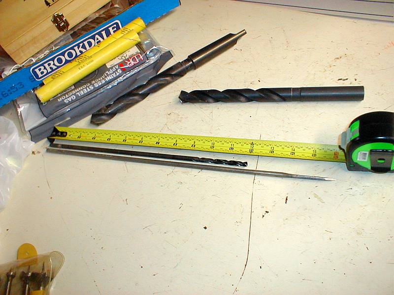

This brings us to a few more bits you might or might not know about. If you look next to the tape measure you will see a 16" spade bit and next to that a 12" twist drill. Can't say if you will ever need or want them but exposure to them can't hurt.
You can also see some larger bits... above the tape measure. These are not something you need for your shopsmith but what I wanted to point out was that the normal looking twist I use for deburring smaller holes. This was a trick I learned in my machine shop days. The second bit with the MT2 will fit in the tail stock and if you wanted to use the lathe mode and spin the stock the drill will drill.
[ATTACH]3708[/ATTACH]
