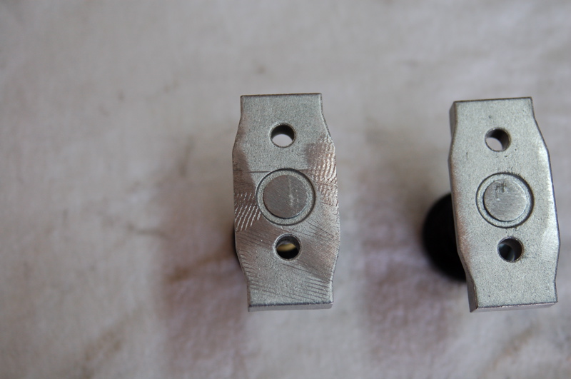

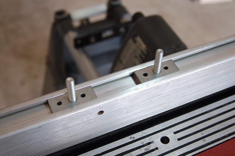

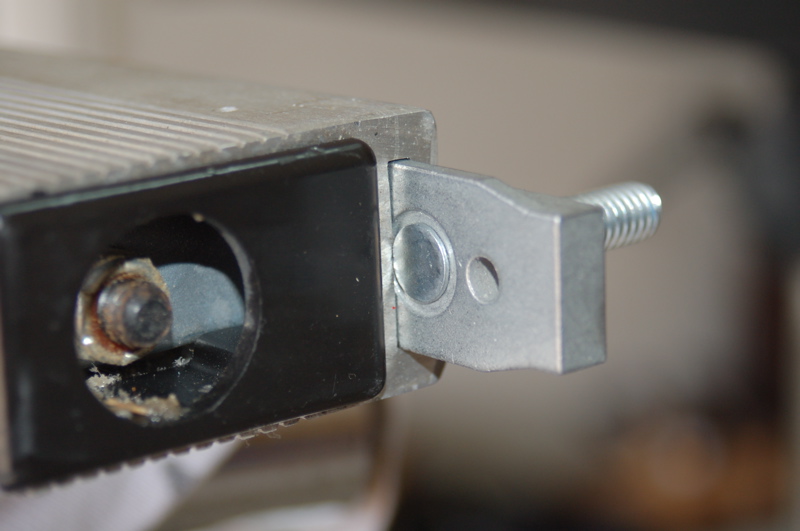

It's working great but, last week I ordered the "Fence Featherboard" from Shopsmith. Saturday while installing, the small (2) metal pieces w/studs that slide into the top grove of the fence are slightly too wide and won't slide into position. I thought about trying to grind them down with something but didn't have a grinder. (Another future Shopsmith purchase)
So, I ended up forcing them into position on the fence by hammering them down the groove with a scrap piece of wood/hammer.
They work great, but are basically permanently set at that position on the 510 fence. Could it be my fence was somehow damaged prior? I purchased this 1993 510 model a few months back and have been restoring, lubing, cleaning and vacuuming since.

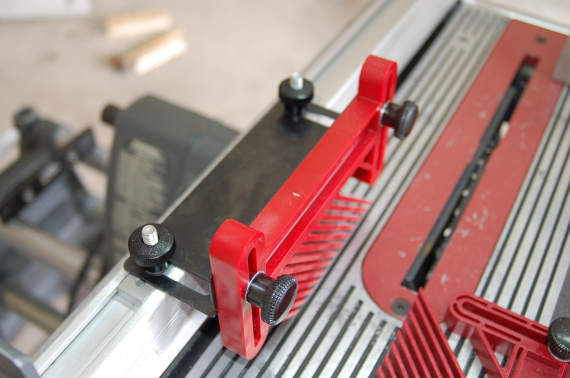

Thanks for the input and idea, I will check the inside edges of the track and see. I felt bad hammering/wedging them in there like that but, I really was anxious to get some mirror edging done. I may be upgrading to the 520 soon which I'm betting these were "really" designed for, although they show to fit the 510.
By the way, in combintation with the regular table mounted featherboards these fence mounted ones worked great!

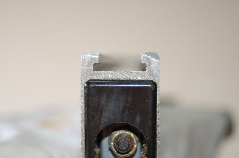

Today I tried to slide those T-nuts into my rip fence slot. No go - would have had to force them just like you. Measured the nuts and the fence top track and found the reason. The nuts "T" measures 29/32" -- the fence slot is 1/64" smaller! These nuts fit beautifully into the saw table as the bottom of that slot is 59/64"
So - if you were to file (not grind) a small amount of metal (about half of 1/64") off of both sides of the wide part of the "T-nuts" seems they would fit your rip fence and would still work in the saw table slots if you ever need them there. The reason I suggest a small amount off of both sides is so there is a maximum amount of metal to hold in all future uses.

I put a caliper on the t-nuts and they measure .875" (7/8". The t-slot measures .905"; just a tad under 29/32".
I would be making a call to Shopsmith. They (their supplier) may have a production line problem (unless they market two different t-nuts).
