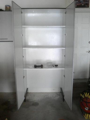

I second what tdubnik wrote. Put together a garage cabinet last summer. Sides were 3/4" mdf 21" x 86". Bottom shelf 3/4" plywood set in 3/8" deep dado with a 1x3 under the back edge. Dadoed edges are glue/with (3) 2 1/2" drywall screws. Shelf has not moved in 6 months
[ATTACH]3754[/ATTACH]
- Installed 3 Small.jpg (29 KiB) Viewed 7105 times
