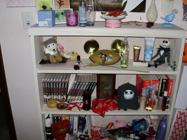

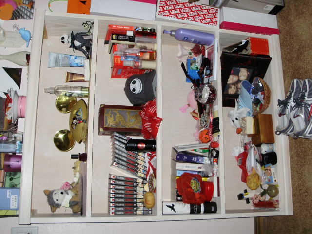

I just finished a book shelf for my oldest daughter's book and stuff. I used 3/4 pine for the project. Dado'd the sides for the shelves and used brads and glue to hold the shelves in place. Pictures attached. Not alot of weight on them as you can see but they will hold alot. I also used brads though the back 1/4 plywood into the shelves for extra support. I am far from an expert just a hobbiest but they seem to be doing the job.
