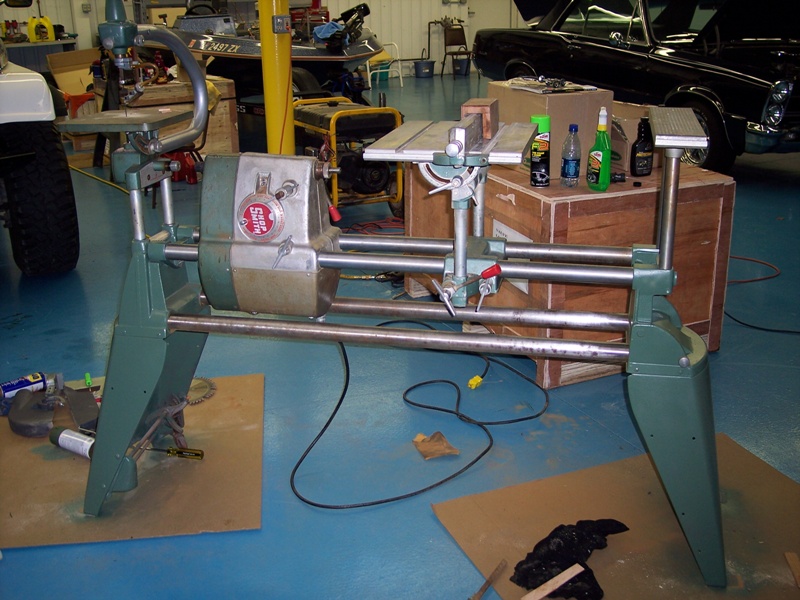

Ok I've got a little ways on restoring My 1954 SS. I thought bout painting it the newer color but decided just to try to match it to what it was supposed to be (green) I found a pretty decent match as you'l see.
The first picture is the picture of it from the person I bought it from. Notice the rust colored primer on the legs.
It basicaly sat and collected dust for quite a while. Aparently the lady I bought it from got it from her uncle. The thing works great.
Hope you like the pics. I still need to work on the headstock some though.

Good job. Looks nice. That ought to provoke me to get started on mine. But no, I believe procrastination is the order of the day. Roger

The 1965 Pontiac really looks nice too along with the boat. I have been buying Shopsmith 500/510 pieces, putting them back together and selling them as completed Shopsmith 500/510s. I never did go with the crowd. I am now restoring a 10ER that is a better build woodworking machine than I had believed. I am using a DC motor and controller for power. I am using the Rust-oleum Hammered spray can paint lately. Faster and more tolerate than power coating. I find that if I bake the parts in my converted power coating oven at 200 degrees for 30-60 minutes really hardens the paint. I am going through all the colors, Gold, Silver, Copper, Black, Grey and Deep Green. They really look good to me.
