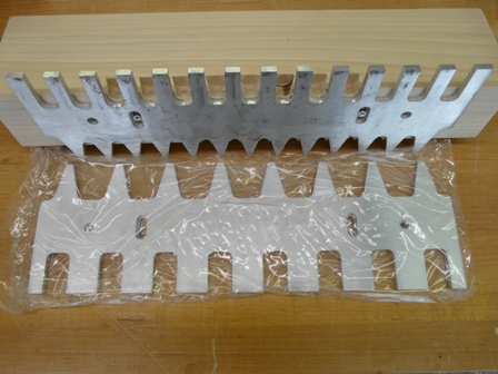

Needing to do a few through dovetails on an upcoming project I have been looking at the Keller System. At $269.00 for the 11/8" on center and $369.00 for the 2" on center jigs I decided to look at options. In the process I came across the MLSC jigs on sale for $89.00 for the pair. I'm thinking its too cheap to be any good. But they work basically the same way using guide bushings instead of bearings on the router bits themselves so I ordered them.

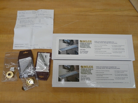

Now here is what you get. Both large and small templates with 1 guide bushing ( I ordered an extra so I could set up 2 routers ) 3/8 straight bit and 14 degree dovetail bit. Better than me try to explain set up just watch this video online. http://www.mlcswoodworking.com/shopsite ... iljig.html

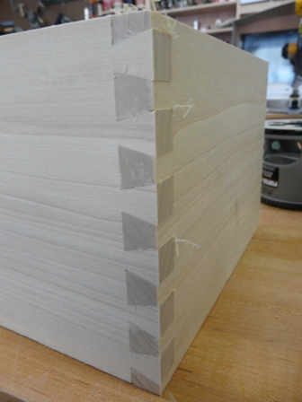

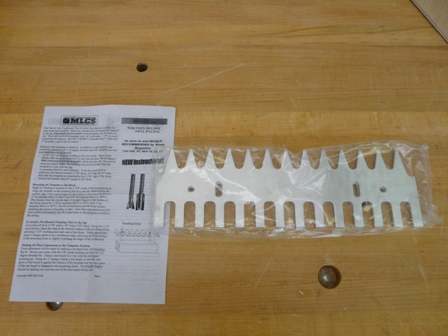

The only hiccup in the whole process was that the item #'s on the jigs did not match the ones in the 2 page instructions. It wasn't a problem after watching the video I new the smaller jig needed to be set at 3/4 inch off set. I used a piece of mdf to gage with and here are my results.
I didn't even have to tweak the set up! :) :)
[ATTACH]4387[/ATTACH]
I don't think you could get better results at any price.

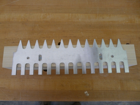

This is the comparison of the 2 jigs. Ill set the larger one up later.
