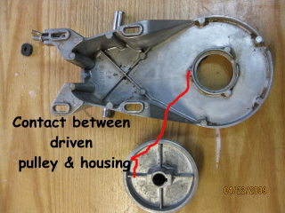

Found the problem
I've found the answer to the knocking noise. Upon disassembly I found that the driven pulley had migrated inboard and was rubbing against the pulley housing. I didn't have to totally disassemble the machin...I found out after the fact...If you look under the table you will find a access hole in the pulley housing that will allow you to loosen/tighten the pulley set screw.
- Problem.jpg (58.91 KiB) Viewed 11938 times
