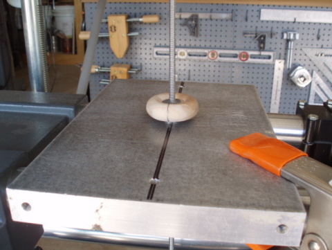

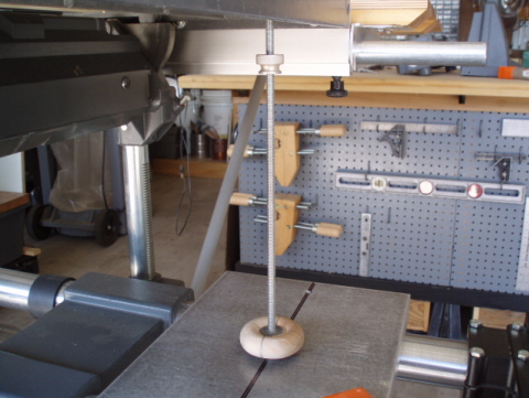

Momentarily it was my intention to just let this lay and rest but....I could not. That is not my nature.
You say that the sine of an angle is not linear and imply that therefore this can't work. Well, I am not attempting to prove that the sine of an angle is linear but I am convinced that the threaded rod approach works and works very well.
With the table sitting at 0 degrees, using the threaded rod, I adjusted the table down to 20 degrees and then back up to 0 degrees in equal increments recording the results at every position.
The increment used was one full revolution of the knurled knob on the threaded rod.
The final conclusion is that one turn of the knurled knob will result in a change of .2941 degrees per change on the average. I have not calculated the standard deviation factor but I have the data if you want to do that. Looking at the numbers and acknowledging that all of this is for use in a woodworking environment where "close is good enough" I have concluded that the threaded rod is an excellent way to adjust the table tilt in mighty small increments.
Mathematically - 1/4 turn of the knurled knob produces a change of .0735 degrees of tilt. I don't think I need to get closer. If I did need to get closer, I would have to find a finer threaded rod. If it is not linear, I don't care.
This number has been empirically verified through four excursions between 0 degrees and 20 degrees in one revolution increments and calculated for changes in 1/4 revolution increments.

Not to nitpick but actually my need to average the numbers does not indicate non linearity. If non linearity was the issue, each and every reading taken would be off by some amount always in the same direction. Your input shows that. As you progress from 0 degrees to 45 degrees the sine increases from .01795 to .70710; it never jumps backward.
Now you did not see my actual numbers so I know you were not made aware that the numbers were inconsistent but you did jump to your conclusion without checking.
Now, having said all of that - when I noticed that the numbers were inconsistent, I made some modifications to my collection methods. I increased the size of the adjustment know and created a rudimentary scale that better allows me to turn the knob in more consistent increments.
With the modified knob, 1 revolution of the knob results in a .1 degree change in table tilt with only occasional deviation. I contribute that deviation to the Wixey - remembering that the Wixey is accurate to .1 degree. I have retested this from 0 degrees to 35 degrees. I am satisfied that this works sufficiently well for all of my tilting table needs. Enough is enough.
