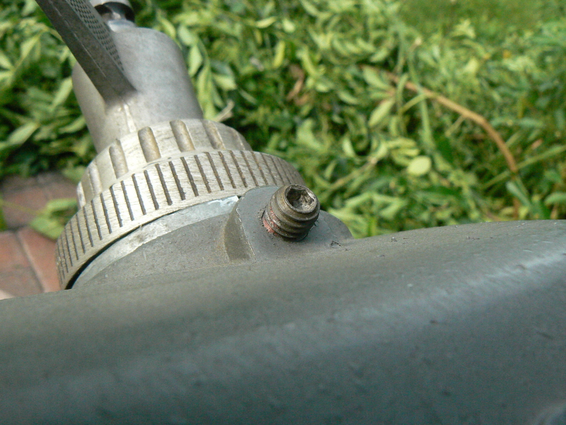

Note the positioning of the quill spring housing is incorrect. The index mark should point towards the set screw.

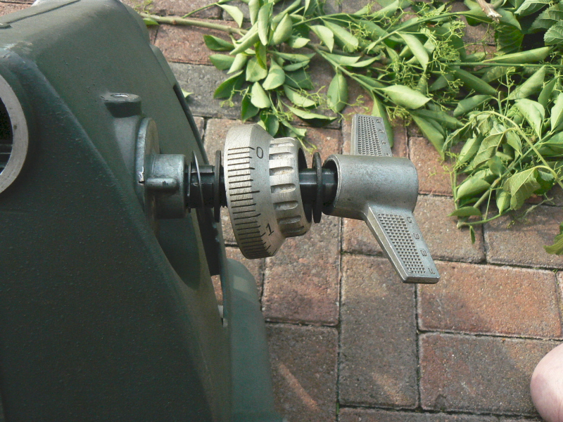

Slide the washers etc. onto the shaft. The flat washer first, ONE of the keyed washers with a 'knurled' surface facing OUT, followed by the dial/indicator, a second keyed washer with the 'knurled' surface facing IN and finally the quill feed stop 'wingnut'. Notice the 'knurled' surface of the keyed washers face the dial/indicator. The orientation of the dial/indicator may be random. Snug up the quill feed stop wingnut.
3/25/19 NOTE: retaining ring in pix behind flat washer is not included in older Mark 5.
12/28/19 Correction: It is the flat washer that is not included in earlier Mark 5s.
Sight down into the setscrew hole and align spring housing with previous marks left by the setscrew. You may need to loosen the wingnuts to orientate the housing etc.
Insert the setscrew and tighten securely.

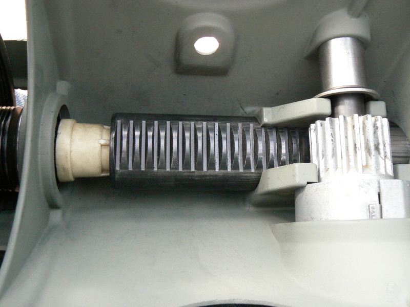

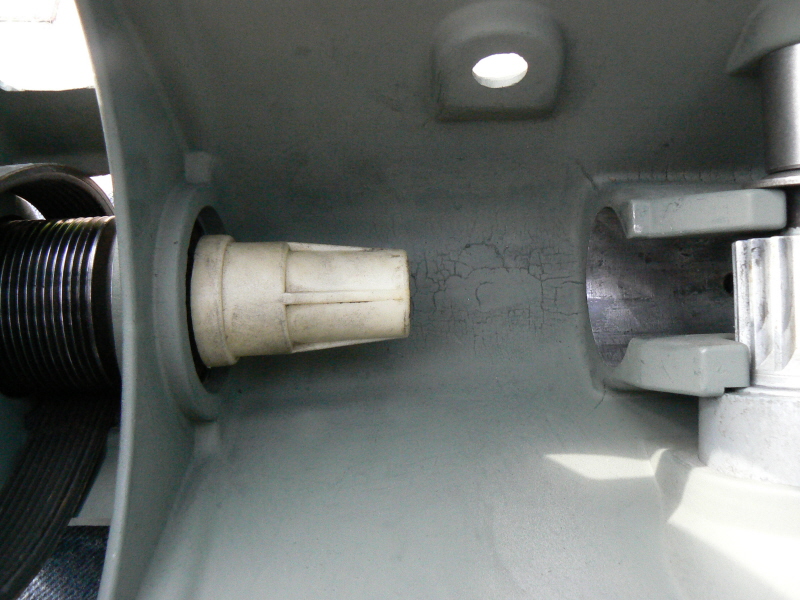

Slip the nylon quill shaft/upper shaft coupler onto the upper shaft. Start the coupler onto the upper shaft by aligning the splines with the coupler. Apply sufficient further force to expand a spring inside the coupler which will cause the coupler to 'snap into place' in a groove in the upper shaft.
