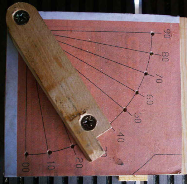

Pattern for the Sharpening Jig from PTWFE
Post by allsas »
I used the posting by judaspre1982 to draw up a pattern for the [ATTACH]5089[/ATTACH] because I thought it was simple and straight forward.
I think that the current Sharpening section(s) of PTWFE have migrated to the SS Sharpening jig?
Any opinion on adding a cleat to the edge, sliding the fence, and protractor down the thickness of the cleat attached to the bottom? Seems that there is enough length and it may stay on the table better?
A [ATTACH]5089[/ATTACH] was uploaded to allow printing of the protractor and using it on the surface of the base as a guide for drilling the pivot hole. It was drawn close together and should print actual size on an 8 1/2 x 11 page. Toggle print to fit option off.
Addendum:
The dimensions on the drawing for the adjustable fence are correct. the drawing shows it as 3 5/8. Wnen I cut my fences. I made them alot longer. Edflorence's fence looks alot bigger than the 1 " high PTWFE plan. When I drilled the screw holes, I made sure the distance between the screws were the same on each of the fences. I assume that an arc of screw holes will develop as the jig is used. A third screw hole through the fence would allow a second arc of holes to position the adjustable fence.
I made printouts to attach to the base. Providing I get it on the base SQUARE, I'll have a starting point for setting the fence or to drill registration divots.

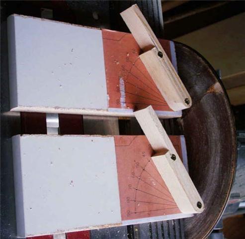

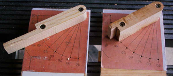

Pictures of SS Sharpening Jig from PDF
Post by allsas »
The Jigs from the PDFhad the miter slot bars and protractors glued and clamped last night. This morning, the fences were modified with a centerline rabbet to point to the marks [ATTACH]5144[/ATTACH]
on the protractor. The fence screw holes were counter sunk on both sides to allow the fence to be used on both edges and to provide space for the material pulled out by the screw entering the base.
The rabbet on the fence can be used to make an offset fence, left, or a full length front face, right. Image . [ATTACH]5145[/ATTACH]
Two fence heights were made 1 " and 1 1/2 ", two lengths were made 3 3/8 and 5 3/4 " . The distance between the holes were the same on all fences. Plated drywall screws were used to attach the fences to the bases. I assume that the holes in the base will need to be reinforced with glue and longer screws used when these lose their grip. The 1 1/2 inch fence had to be adjusted to make it square to the base.
Two other jigs set with long fences surfaces for aligning stock and set at 30 degrees because edflorence uses that position most. The offset fence position may allow positioning a chisel closer to the sanding disk.Image
ShopSmith Bench Chisel Sharpening Jig - alignment at 30 degrees.jpg (46.09 KiB) Viewed 5734 times
ShopSmith Bench Chisel Sharpening Jig - both fence positions.jpg (24.5 KiB) Viewed 5762 times
ShopSmith Bench Chisel Sharpening Jigs w Disk.jpg (29.16 KiB) Viewed 5752 times
