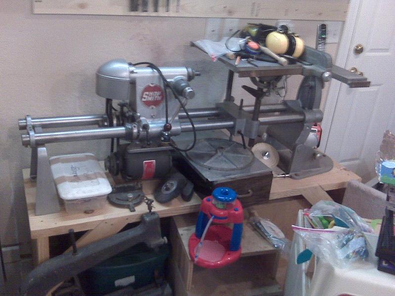

Just so you know, here's a photo of my 'Old' shopsmith, SN# 23299...
Restored it last summer. You can probably tell it doesn't get much use with all the junk on it. (Kids!)

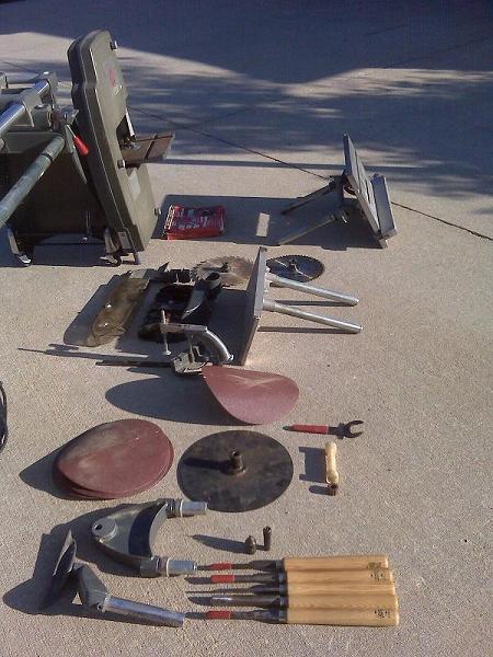

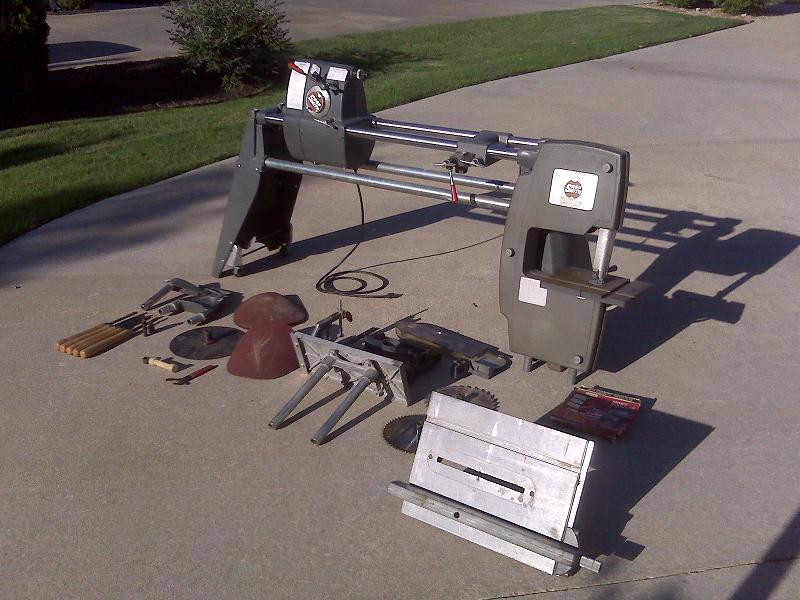

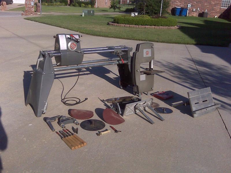

And my Trade up!
Got this one today - lucky hit on Craig's list...$500.....SN# 222659.
Runs fine, but want to do a complete going over first.
Will need some advice as what to do first.
Don't want to screw this one up before I get started...

Start here http://www.shopsmithacademy.com/SS_Arch ... rn_Pt3.htm Thus making sure all the 'moving' sheaves are 'moving'! There are oil holes in the floating sheave and the control sheave. Put several dropsdontolbert wrote:Got this one today - lucky hit on Craig's list...$500.....SN# 222659.

(10W machine oil(electric motor/3 in 1/'turbine') in each. Make sure some oil migrates to the small button bearing in the end of the control sheave. Check out the other saw dust sessions which deal with other areas of the headstock. All this gets you an understanding of how the mark V works. BTW the location of the poly-v belt on the drive shaft seems to vary. Some require the poly-v belt to be back further on the drive shaft(more than 1 'empty' groove). Yours PROBABLY needs to be in the third groove(2 'empty' on the front).
