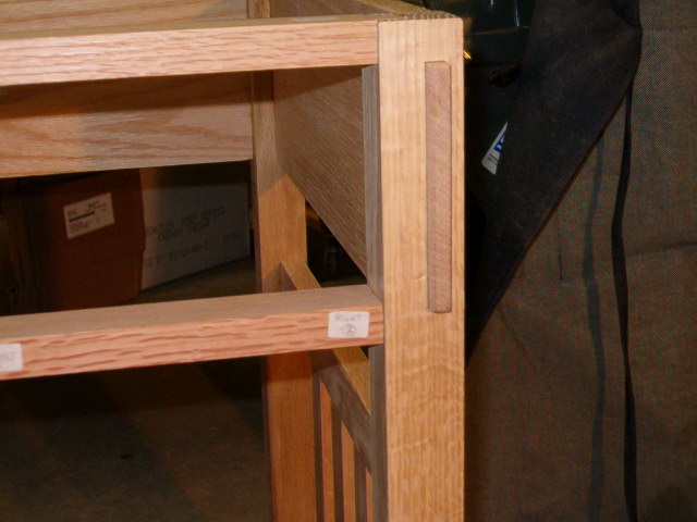

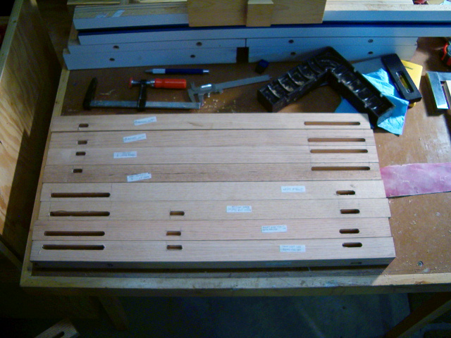

These mortises including the thru ones, were done on an OPR - however the legs were only 1 1/2" X 1 1/2". I think drilling is a good solution for 3" wide legs. I'd still clean them up and square the corners with my OPR and a chisel.
[ATTACH]5268[/ATTACH]

Here is a joint problem that is worth pointing out! -
One of the things I did wrong here was not orienting the grain correctly for the thru mortise. As you can see in my second photo - I should have rotated the leg 90 degrees before making the mortise. That way, any wood movement between the mortise and the tenon would not be at right angles. In the case of the above pictured joint, the legs movement will be mostly along the tenon, while the tenon movement will be mostly sideways. This potential movement will tend to weaken the joint over the years.
My error in this case was caused by being more concerned with the appearance of the surface grain than the joint grain. An error that makes the joint simply not as good as it could have been. The joint is pinned. That will help somewhat, but it could have been better.
