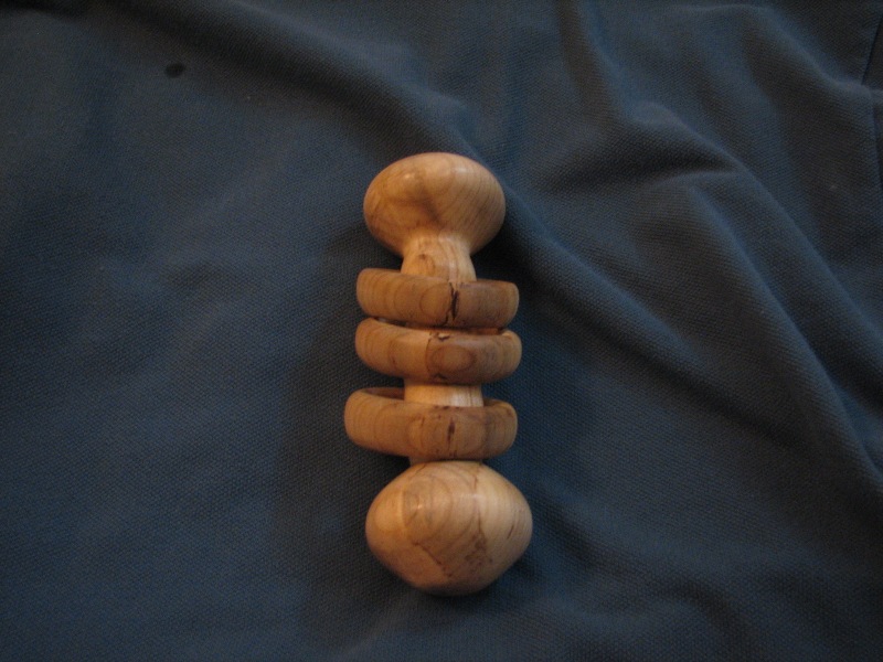

Does it really rattle? What do you use and how do you get it inside?

I use what is called a captive ring chisel made by Sorby. I am attaching a link to what the chisel looks like and also a link from a woodturning site that explains how to make a captive ring rattle. Also a larger picture of my avatar. The rattle effect is the captive rings which slide on the center of the rattle. I use sugar maple for my wood and sand and buff the rattle to super smoothness then a coating of pure virgin olive oil buffed to a shiny finish. It took a few try's to get the method of turning the rings figured out.

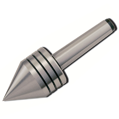

The live center is not included in the kit I spoke of. It is recommended to use a live center with a 60 degree point to align the mandrel so that you don't possibly damage the smaller point on the SS live center.
This is the one I purchased for doing pens.
http://www.pennstateind.com/store/LCENTLT2.html
[ATTACH]5521[/ATTACH]
It works quit well but it did add about $20 to my startup cost. I feel it is insurance against needing to replace my SS Live Center.
