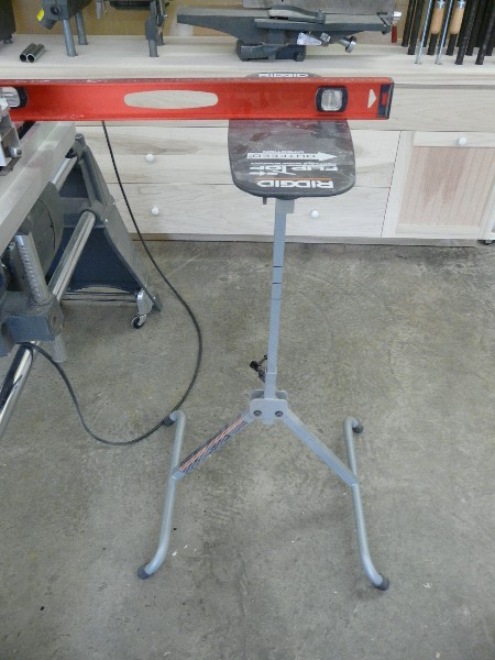

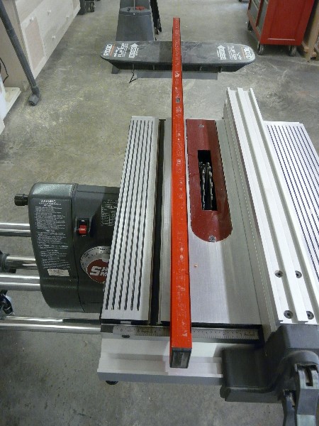

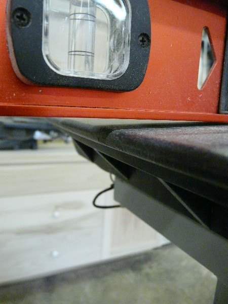

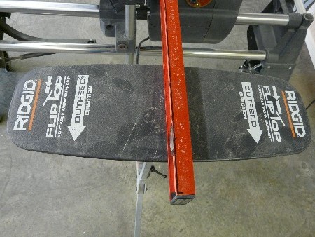

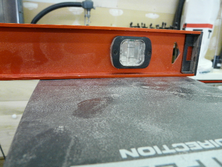

There is always much discussion here on the subject of infeed/outfeed support. I am posting pictures of one of my flip tops from home depot. I use these with about every tool in the shop and is the only thing I use with the SS. I like them much better than the roller style due to the fact that they don't have the tendency to roll stock back at you.
[ATTACH]5645[/ATTACH]
[ATTACH]5646[/ATTACH]
[ATTACH]5647[/ATTACH]
They are easy and quick to set up. I keep them waxed and stock slides nicely.
[ATTACH]5648[/ATTACH]
[ATTACH]5649[/ATTACH]
Notice the gap between the level and the flip top in the first photo. As you slide the stock onto the top it flips or levels out with the work. I find these to be safe and solid work supports and between 20 and 30 bucks.
