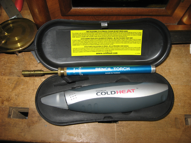

That's interesting, I got one for Christmas a couple years back and think it's great. I generally use it in areas where there are heat sensitive components and especially for weight cords. When putting new cords on a tall clock I tie a knot in the ends and apply some solder to keep the end from unraveling. These cords have a braided brass sleeve with a nylon core, I used to use a small butane torch but with the torch, timing is critical as once the cords ignite the resultant soot will keep any solder from sticking. The "cold heat" soldering iron heats the brass cable first and allows me to get as much solder in as I want without igniting the core. The tip of this iron is made from two pieces of carbon and the item to be soldered must be able to form a short between the two. Otherwise no heat.
I do get a lot of use out of the butane torch and consider it one of the best $3 I ever spent.
Troy
[ATTACH]5678[/ATTACH]

- IMG_4352 - Copy.JPG (437.53 KiB) Viewed 5773 times
