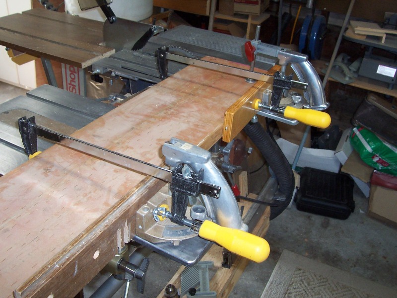

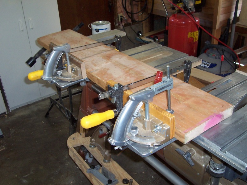

Here is a set up I used for cross cutting the ends of 4ft 2 x 10's on my model 500. Worked ok with the extra main table and miter guages. I think a 6 ft board would have been ok too with a little more support on long end.
[ATTACH]5670[/ATTACH]
[ATTACH]5671[/ATTACH]
[ATTACH]5672[/ATTACH]
[ATTACH]5673[/ATTACH]
