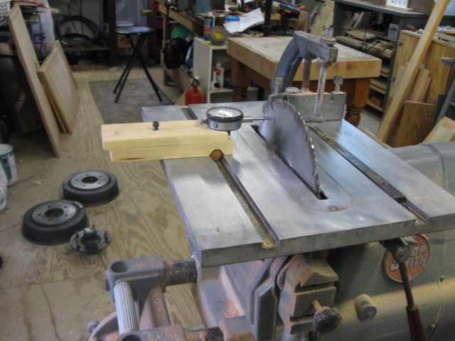

what is the brand name of the indiactor offered by SS. With 40+ yrs. as a tool maker i have used indicaters on a daily bases, so i needed good indicaters that would hold up to that kind of use, Federal, Starrett, Interapid, and Mitutoyo are the indicators that i own and have used since the early 60's. Working in a tool room i had to have good jewel movement indicators, but for the hobbiest a cheaper one would probable last ok. The picture below is of the holder i made to fit the SS table slot, the holder has a dove tail slide.
( NOTE : The blade i have on the SS is a hallow ground and not a good choice to use for indicating yet that is the blade that was shown on the email i got this week from SS for the sale of indicator.)
- 002.JPG (121.43 KiB) Viewed 6806 times
