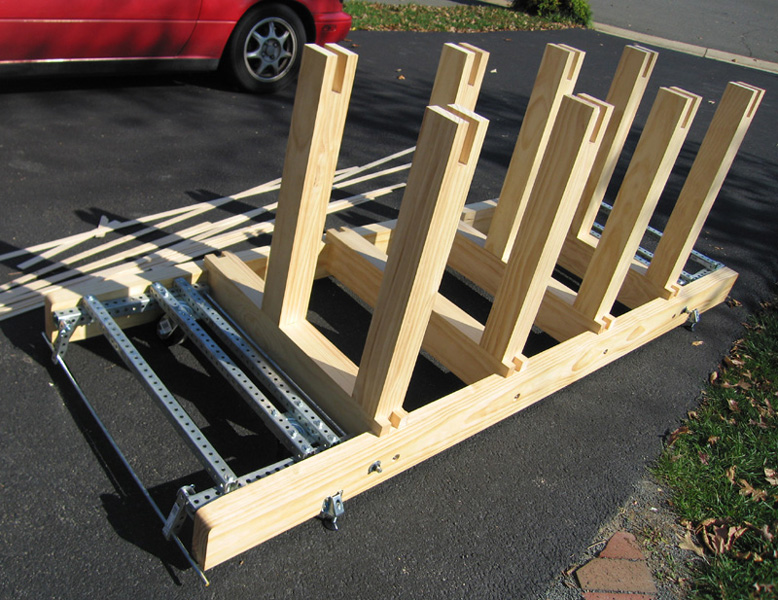

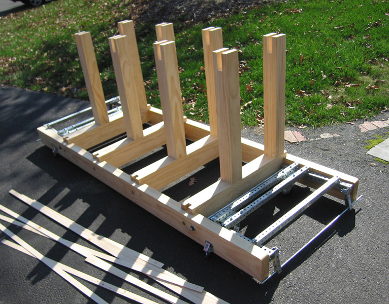

In Progress
Well, I've been picking at this for several weeks now, and wanted to share:
I have glued up most of the top, and will be planing it next weekend.
The retractable casters work awesome. I was worried that they would be too wimpy, so I totally overbuilt them, and they work like a charm. I will be putting some kind of pedal on the bar so it looks nicer, but right now, it is working great - it feels almost silly how easy it is to raise and lower it. I have loaded up the glued-up top, a bunch of lumber, my chop saw, my mortiser, and a portable router table on top of it all, and it both lifts and rolls easily.
W4F - I ended up using a blocking similar to what you suggested - one 2X6 with slots cut into it glued to another 2X6, then matching cross-members to fit into the slots. It's nice and rigid. There is a little racking (like you thought ther might be) so I'm going to get a sheet of plywood, rip it in half, and then use it to tie the suproting legs together at multiple points.
I'll post more pics when its all done.

- Frankenbench1.JPG (247.63 KiB) Viewed 2872 times
- frankenbench2.JPG (226.18 KiB) Viewed 2851 times
Looks like it's coming along great, RiotNrrd. Should be solid as a tank when it's done.
Can't remember ever wishing I'd made a storage/utility unit LESS strong.
