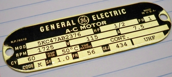

Recreated motor nameplate - Waterslide decal process
Here's my recreated CUSTOM brass motor nameplate for the ER10. I decided to try a water slide decal process instead of the acid etch process used for recreating the main ShopSmith nameplate, reason being, I didn't think the tiny lettering above the information blocks stood a chance at making it though the acid bath without getting etched away. Water slide decals are the same we used as kids when making models.

I bought a 5-pack of the clear inkjet water slide decal stock from Papilio.com. (~$15.00 with shipping) I was going to buy from Testor’s but it took them 2 days to answer an email I sent asking them a question. After 1 day, I located the other source. Couldn't wait! Too bad.....I spent a lot of hard earned paper route money with Testor as a kid.
Process was pretty straight forward.
1.Prepare your artwork. Blank GE motor artwork below.
2.Prepare your metal sheet stock. I used .032” thick brass.
---a.Sand the front surface with 1500 grit sandpaper on a mirror or flat surface to make it shine. Double sided tape works well here.
---b.Coat the back surface with 3 or 4 light coats of clear lacquer for protection and allow to dry for 8 hours.
3.Print your artwork to the correct scale onto the waterslide decal paper and let dry for a couple hours.
4.Coat the inkjet image with "fixative" (similar to a clear lacquer) to protect the image when you submerge it in water then let dry for 8-hours.
5.So that the decal slides easily on the nameplate once initially applied, spread a very light coating of “decal mounting fluid” on the nameplate surface. This allows you to make fine adjustments sliding the decal into position without it stretching or tearing.
6.Put decal paper in warm water to loosen the decal.
7.Apply decal to the nameplate.
8.Squeegee out all air bubbles, water, and the decal mounting fluid with your finger OR preferable, a small curved plastic squeegee, similar to the one shown toward the bottom of this page.
9.Sit back and watch your masterpiece dry for about 2 hours while enjoying a tall glass or two of your favorite beverage.

- Original nameplate
- Water Slide Decal
- .032" Brass stock trimmed to size
- Finished part

Mike, that turned out really nice. Great work.
