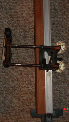

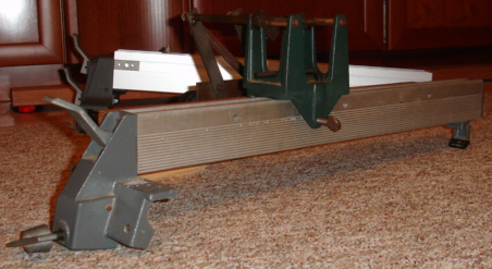

JPG40504 wrote:For OUR education, take pix after you are done! PLEASE!

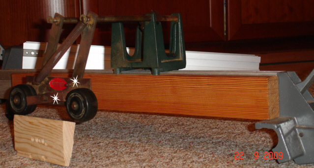

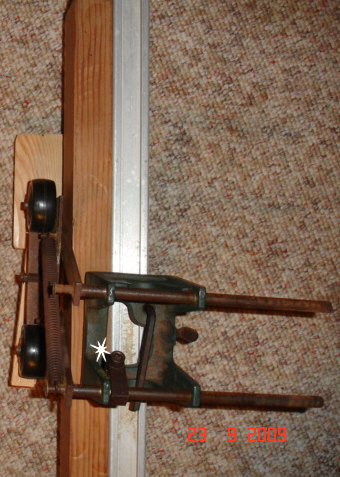

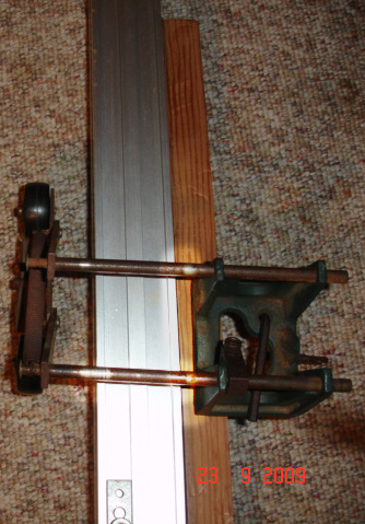

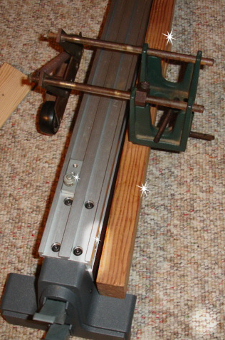

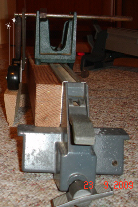

[ATTACH]6052[/ATTACH]
[ATTACH]6053[/ATTACH]
[ATTACH]6054[/ATTACH]
[ATTACH]6055[/ATTACH]
[ATTACH]6056[/ATTACH]
510 T wide.jpg (73.16 KiB) Viewed 9561 times
510T thin.jpg (126.09 KiB) Viewed 9585 times

How's that for planning? Pics w/o captions. This for the previous 5 pics:
1. star= spring peg for left miter slot use]6057[/ATTACH]
stars= placement for T-nut bolt holes; (T-nut sitting in side T-slot)
[ATTACH]6058[/ATTACH]
the rods are angled in the R-S Base; the Base is further angled in the aux fence, to accentuate the force driving the workpiece in to the fence (this may be something I "added").
So, the "sacrificial fence" and adjustment range mentioned together woke me up to moving the Aux fence to the other side. I didn't think it would fit. (ahem) I didn't think.
I'll just use threaded inserts and two 1/4-20 bolts to engage 2 T-nuts in the right side.
'Tis a relief. I've gotten to rely on this old thang, for safety and ease of use when ripping most stuff.
520 SE.jpg (120.09 KiB) Viewed 9599 times

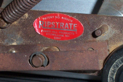

Does anyone know where you can get a Rip-Strate these days? I haven't seen any on ebay or craigslist. Looks like a tried & true design. Is anyone still making them?
I did find a similar but different design at Woodworker's Supply:
http://woodworker.com/fullpres.asp?PARTNUM=96974&LARGEVIEW=ON
But it is 2 separate jigs (one wheel each) with wheels that can be adjusted to be anti-kickback ratcheted or not. Each jig lookslike it has enough slop in the bolt slots to ride the wheel slightly toward the fence. Based on your knowledge of the Ripstrate, is this 2-jig product equivalent or missing some major features? Seems like twice the setup adjustments.
-w4f

Post by keakap »
[quote="wood4fun"]keakap,
I'll try a search, but I'm not very good at it, so don't hold yo breath!
Fisher Hill Products Inc
572 Rhododendron Rd
Fitzwilliam, NH 03447
Phone: (603) 585-6883
Website: Information not found (?)
Woodworking machinery in Fitzwilliam, NH
Mfg Woodworking Machinery, Sawmill and Woodworking Machinery Manufacturing
Fisher Hill Products Inc Business Information
Fisher Hill Products Inc is a private company categorized under Woodworking machinery and located in Fitzwilliam, NH. Current estimates show this company has an annual revenue of $160,000 and employs a staff of approximately 2.
FWIW
RipStrate label.jpg (90.7 KiB) Viewed 9297 times
