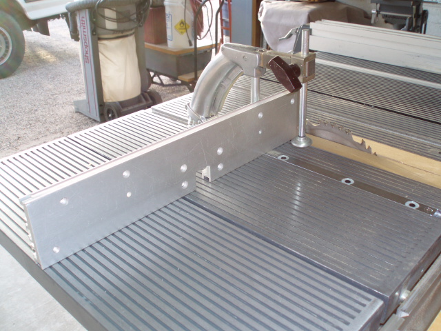

jmilligan wrote:I appreciate the hard questions. They helped me to think through what I am asking for. I use a sliding rip table in the miter slot to make straight cuts. That works fine with larger stock. Where I have problems is making angled cuts with longer stock. I have problems holding stock against the face of the SS miter guage with out it moving. Is there an attachment for the face of the SS miter guage that provides a larger, longer surface like the Incra miter table?
Yes there is an attachment that extends the face of the miter gauge and provides for flip stops. 20" Aluminum Extension 556005 lists for $62.95
All that you are really needing is a fence (piece of wood, aluminum extrusion) to attach to the face of the protractor. If stops are required, a little ingenuity.
Here I have attached a fence from the original (short) Incra Jig. I now use it with the miter gauge (re-purposing in action). I use the fence with either the Incra V120 or the Shopsmith Miter Gauge.
[ATTACH]6154[/ATTACH]
Care is required. The fence is vulnerable if you don't pay attention when adjusting it. I have a couple saw marks that prove carbide is harder than aluminum.
- PA080005.JPG (155.27 KiB) Viewed 7442 times
