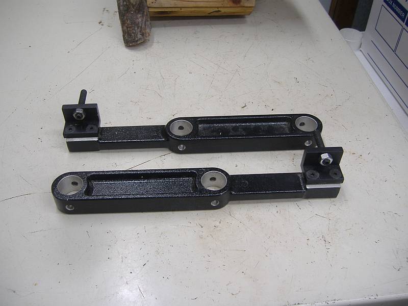

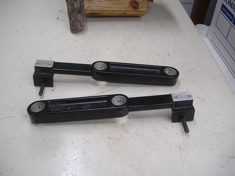

Hi,
Those brackets are shopsmith parts. They are called "extension table brackets" part number 555997.
http://www.shopsmith.com/ownersite/item ... =Find+Item
- Posts: 35457
Thank You Gentlemen!
Ed your pix showed it all.
Are the set screws that tighten the extension to the tubes both on top and bottom?
