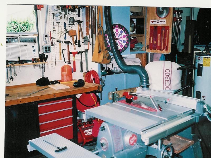

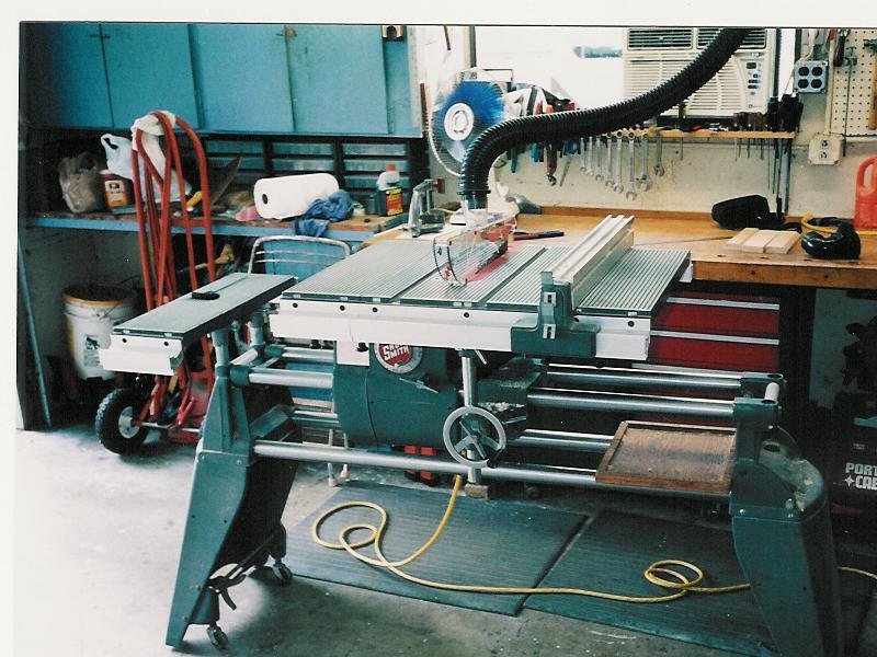

All this talk about saw guards you might want to check out Sharkguard. They now make one for the SS 510/520. With it you can remove the actual guard but keep the riving knife in place. Plus you pick up the added vac port when you use the guard.
http://www.leestyron.com/sharkguard.php
Here is one mounted on my SS
[ATTACH]386[/ATTACH]
[ATTACH]387[/ATTACH]
- shark1 001.jpg (102.79 KiB) Viewed 13469 times
- shark1 004.jpg (93.51 KiB) Viewed 13469 times
