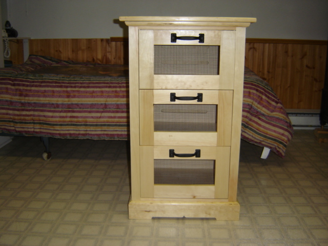

I am attaching a pictutre of the previous one I had made (didn't have this problem with that one). The picture shows the front with a decorative cut-out. The two sides have the same cut-out so that at the front corners there is 4.5" x 2.5" touching the floor, and at the back corner only 2.5" on the side as there is no back base panel.
I hope this helps. I had a better close-up picture but it was too large to post.

Do you still have the back to put on? If so, maybe this will help - -
You can test to see if the back of the case is square by measuring corner to corner. Actually a story stick will work more accurately. If not square, tighten a clamp across the two back opposite corners (the long leg to the upper side opposite the long leg) If the clamp will square it up. Then place a square panel onto or into the back.
If the back is already square, Make your back panel so it is a parallelogram. All you need is 1/16" down on one back leg and the other 1/16" up.
Best wishes!
Best wishes!

If the cabinet is knot fully assembled, Chuck has your solution]this[/URL] might be your solution. Here is another site.
Tim
Chuck:
I really hadn't thought of measuring to see if is square, but I'm not sure I could square it up at this point since there are so many glued and screwed components. The whole thing (carcass) rests on the three base panels and I think my problem is that one of the side panels might be slightly off. I should have dry assembled it first, and adjusted if off, but since my front corner miters were so good, I figured it was OK and the three base panels are now glued on and tacked on with finishing nails on the back side. I think any adjustments will have to be to the areas touching the floor or go with Tim's idea.
Tim:
Thanks for the suggestion. My wife and I already discussed attaching a feet, but this would raise the bin off the floor a bit and I was trying to avoid that. I used something similar on a wine rack I made last year and on that project it looked good and kept the rack steady. In the end, this may be the only solution.
Tim:

Hello John from another John, If only one back corner leg is above the floor with the other three touching pretty evenly, you may want to glue a thin (@ 1/8"?) shim of same material onto the legs of the short corner and then sand down a little at a time until it sets level. Another option is to level the unit and then scribe all four corners using a guide spacer and then belt sanding to the scribed lines. This works well on chair legs, but might be more difficult on your base corners. Good Luck, John McCrossen
