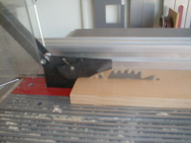

muncyjohn wrote:.
IMO the SS guard is not going to prevent kickback as the kick back pawls do nothing that I can see,, ie,,, if I rip a 3' board half way through then turn the saw off, I can pull the board back to me with no problem, yeah that is great in that it does not mark my wood but on my Craftsman TS the pawls would bite right in to prevent me pulling it back.
john
I really don't know what to suggest. This is one of those problems that you sort of have to see to understand.
I just came in from the shop after ripping up three or four pieces from the scrap box to see if I could back out from under the kickback pawls (after turning the saw off). I can not, even by backing out really slowly.
Check the pawl mechanism to see if it moves up and down easily and doesn't hang up elevated above the board you ripped. With nothing under the pawls, this mechanism should be at its lowest position.
With the saw off and the blade guard up so that you can see, slide a piece of 1/2" stock along side the blade and watch the pawls. Do this on both sides of the blade. Do you see the pawls rotate to the back and raise so as to rest on top of the stock. If they do, stop. Slide the 1/2" stock back out, watching the pawls. The pawls should begin to rotate back the other direction and capture the stock so that it will move no further.
In your photo, there appears to be more clearance between your blade and the riving knife than there is on mine.
I apologize for the poor quality photos; I'm having some camera problems. Hope you can see well enough.

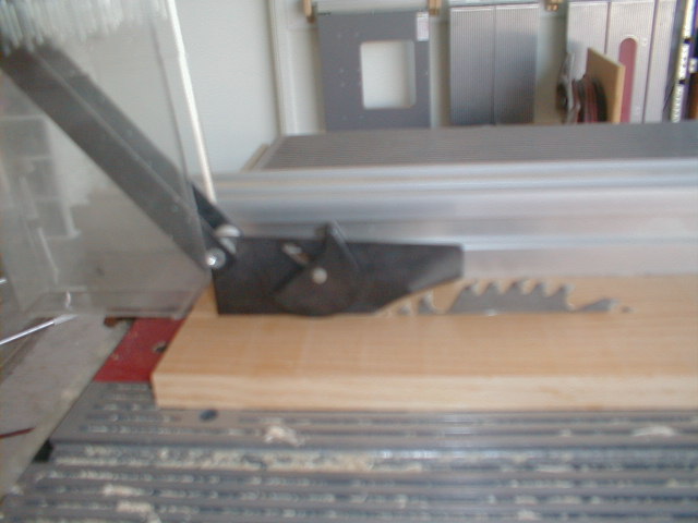

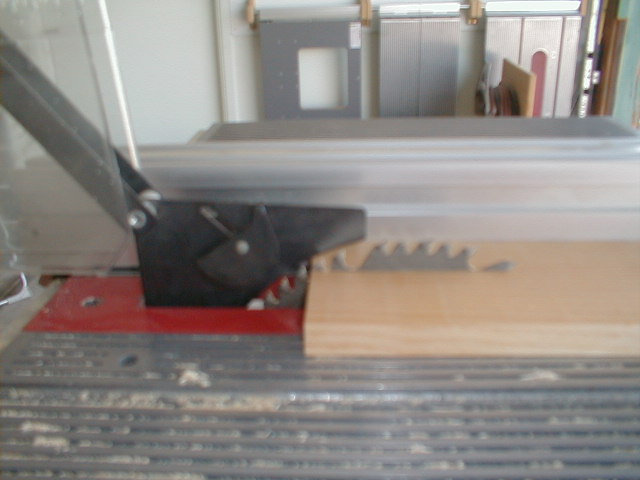

paulmcohen wrote:Do you have a picture of this thing, I have never seen one for the Shopsmith.
Do you have the Upper Saw Guard? If you do, 514367 is a part of the Upper Saw Guard. The metal piece that secures the saw guard to the table. If you don't have one, let me know and I'll post a picture.
muncyjohn wrote:Well Ed I think you did a very good job addressing this, and I respect your opinion.
I immediately went out and tried what you said, cut a little more length into my test piece so I could get a little more jerk length, of course the piece I used had to be white oak:D .... I lifted the guard for the pic....
Maybe there is something wrong with my setup, I don't know but as hard as I could push or pull it ... no catch
Hi,
I didn't have time today to go out to the shop and try the "fast pull back" to see how true my statements were but I think the concept of how it should work was tried by dusty, and his seems to work.
I looked at the picture but for all I can see it looks like a normal set up. The pawl parts should move freely and not hang up, that is something you can check on.
I will get out and give my two a try and see what happens. I really work hard at not have kick-backs and as such I never seen mine in action it that situation. I would hate to find that they didn't work so maybe this is something we all should be looking at as part of an extended safety issue. I'll try to post results by mid day tomorrow.

Thanks Dusty for the fine pictures, no problem seeing! Later today when I get up I will compare the positions as illustrated by your pics, it looks like the last one you have is where you were pulling back.
Glad to hear that yours is working fine, like I said maybe mine is faulty!
