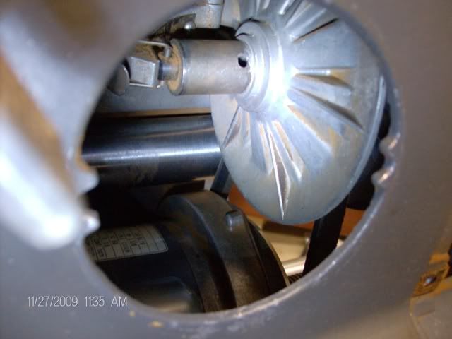

The hole behind the Shopsmith nameplate is easy to find. Putting three drops of oil in that hole, using a stick (the manual's method) is not so easy.

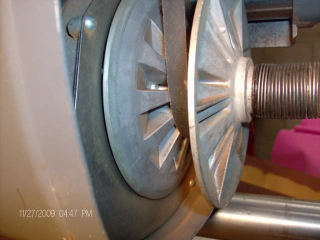

Finding the hole on the motor's shaft is much more difficult (impossible if you follow the manual's instructions). Here the sheave is spread wide apart -- set at the slowest speed setting. This will never work. The hole is under the spring, which is very tight at the slow speed setting. In fact, the hole may be under the sheave.

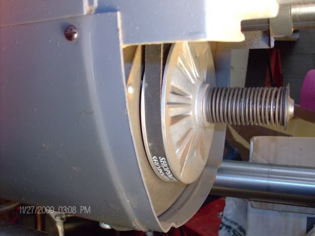

To access the hole, you have to set the headstock at the highest speed. This compresses the sheave and makes the spring as loose as possible.

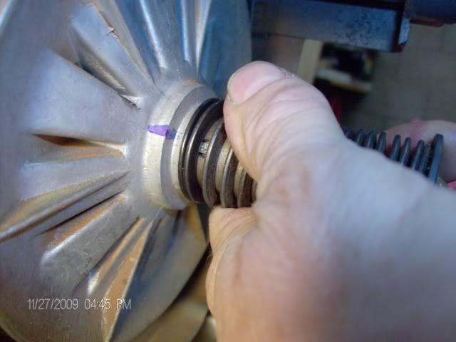

I think this is the hole and hope one of you can confirm. I was expecting it to be about 1/2 inch away from the sheave as the manual states. If this is not the hole, I oiled the wrong thing. Once you find it, mark it with a permanent marker.

Re: Motor oil hole - Yep you found it. Notice the key way 'key' under the hole. This is what transfers the rotary motion from the motor shaft to the sheave. Do not be bashful oiling it. Up to 10 drops is not a bad idea! work the sheave in and out by hand(pulling it out and allowing it to return(DO NOT LET IT GO).
