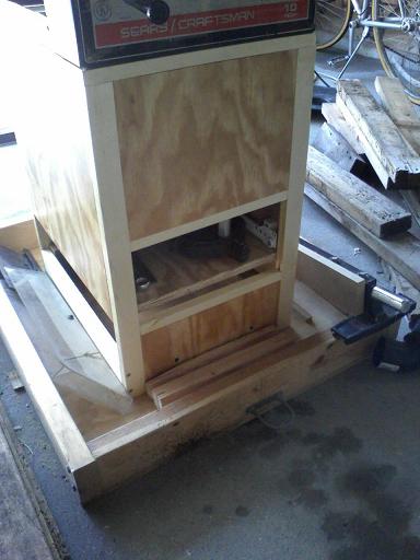

I've used a tongue and groove joint to attach plywood to aspen. No issues whatsoever, which is probably a good thing since my table saw is sitting on top of the cabinet I built using this method.
[ATTACH]6715[/ATTACH]
- New Stand Small.jpg (50.67 KiB) Viewed 9097 times
