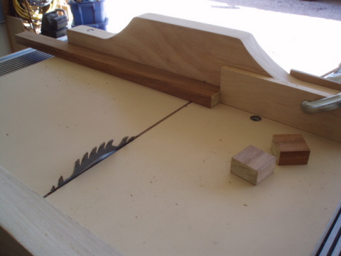

With the season coming on and the recent discussion on potential safety hazards, I was forced into action. I am hoping that this will satisfy my production schedule while at the same time improve Table Top Safety.
Feedback Please - positive and negative!

That's a great looking sled, Dusty! The only danger I could see would be the exposed blade behind the sled as the back of the sled passes the blade. But that might be picking nits.

heathicus wrote:That's a great looking sled, Dusty! The only danger I could see would be the exposed blade behind the sled as the back of the sled passes the blade. But that might be picking nits.
No, that is a value criticism and appreciated observation.
You know that feeling (small voice) that has been mentioned. I sorta felt (heard) same when I was testing this. That may be the reason for the sensation.
I don't want to trade one reason for cutting off a finger for a different one.

Do you think it is heavy enough?
You are to be commended for quick action. I have been procrastinating on mine for over a year.
Looks good, just be careful about the blade coming through the push bar and trimming your thumbnails.

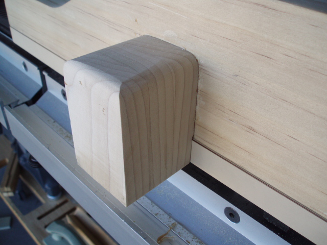

If you take a small corner off of the bottom of the stop block (maybe about 1/4" to 3/8" high it will keep sawdust from piling up against the end of the stop block and getting compacted into a accuracy destroying lump.

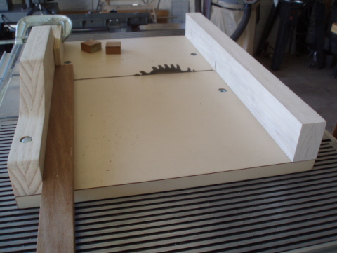

Thank you for the input. I have incorporated two quick changes.
The stop block has been champhered on two edges to reduce unwanted interference by saw dust accumulation.
A dog house has been added to the back side of the fence. This will prevent blade exposure at the end of the cut.
[ATTACH]6781[/ATTACH] [ATTACH]6782[/ATTACH]
PS Really ugly glue job. It is too late now but I really should have cleaned up the dog house while I could do it on the belt sander. Now it is a hand sanding job. Not smart. This is sorta like accidents - the direct result of haste.

What is a dog house? I know the big one in the backyard, but not of the one which Dusty mentions.dusty wrote:Really ugly glue job. It is too late now but I really should have cleaned up the dog house while I could do it on the belt sander. Now it is a hand sanding job. Not smart. This is sorta like accidents - the direct result of haste.[/SIZE]

The dog house to which he referred is the ugly glue job appendage he added to the 'front'(the push bar) of the sled so that the front of the saw blade would not be exposed as the cut is 'finished'. See the last pix!

As JPG has explained, I hung this on the back so that the blade was less likely to be exposed when the sled was pushed way forward during a cut. Suppose to prevent an unplanned manicure.

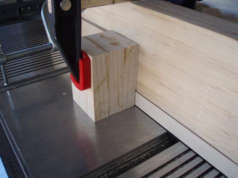

[ATTACH]6783[/ATTACH]
It (the sled) still needs some finish work but I sorta think this is a prototype. I have done several things that I would want to revise before I called it "my design" and "finished".
Like most all of my projects, I change more details on the fly than were planned to start with. Most of my projects, especially the successes, are real surprises.
