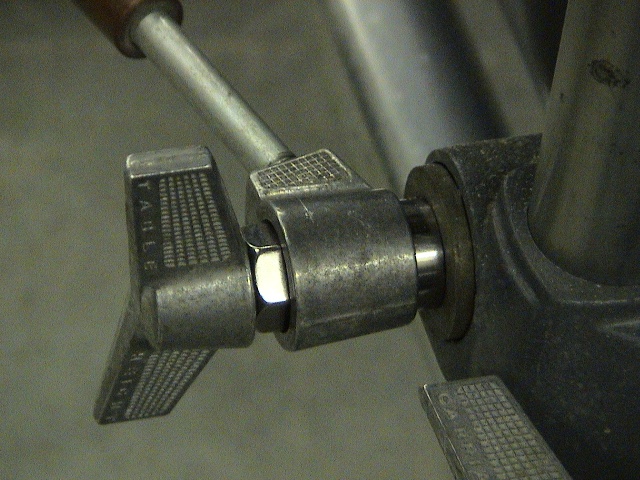

I always wanted a shop smith and was talking to a friend about things and the subject came up about wood working and I told him that i would like to get a shop smith some day. Well he said he had one that was given to him and he was doing nothing with it and it was just taking up space in his shop and said I could have it :D . Now it sits in my shop waiting to get cleaned up and ready to run. Motor works fine. I don't now if I have all the things that came with it when it was new so I ordered the manual for it. It was missing the part that cranks the saw table up and down. I have the handle but missing the part that goes on the 3/8'' square shaft. So I used a 3/8'' drive x 5/8'' deep well socket, it fit on there just fine like it was made for it. Now I can lock the table in place. I look forward to getting other parts for doing wood working. I have done some back in high school but that was a long long time ago.

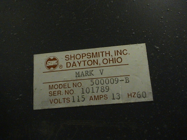

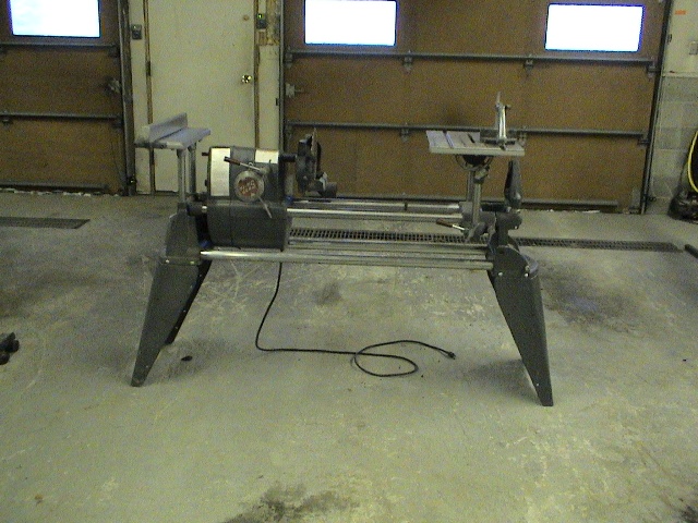

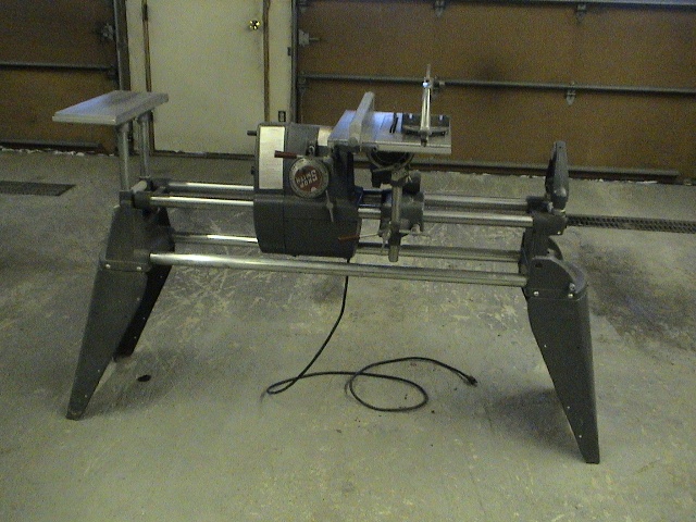

Here is some pictures of my Mark V. And one with the made up part that I was missing for the table crank handle.
Clyde

She looks to be in GREAT condition cj. You'll be very glad you have it.

Congratulations and welcome to the forum. Looks like it is in good shape.

I looked into getting the round crank handle but shop smith said it would inter-fear with other parts of the table. So I made the part i needed.
Clyde
