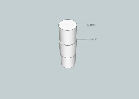

JPG40504 wrote:How about the 'slip joint'. Is there hardware for that 'function' available somewhere? The collar suggestion is a good one, but slip joints are easier/quicker if not 'better'.
I do not understand the term "slip joint" as it would apply to this discussion.
Slip joint pliers or slip joint pvc couplers I get. But not in steel tubing - however, by association I assume it is similar to pvc couplers.
I think this sketch will show what I have had in mind - and I think I am going to have to turn it. That might be a fun learning project since I am not much of a turner.
[ATTACH]7023[/ATTACH]
This would be used to joint two shorter sections of extension tubes together.
Why, you ask? I think that it might be a solution to the problem of having to break down setups involving extension tables when you want to change height of the main table.
FLEXIBILITY
