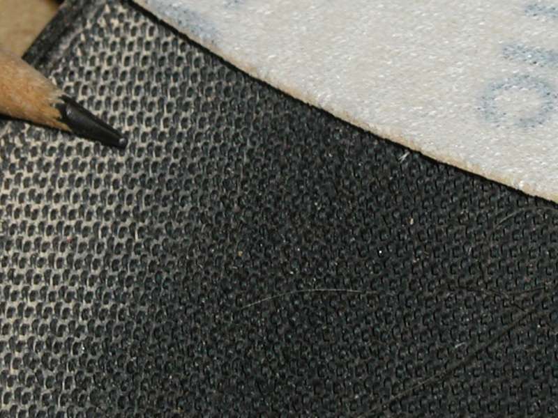

thanks for all the reply's. I have managed to take a few photos of the disk. My poor old camera is not doing too well.
As you can see I am starting to believe that the hooks have dried out and broken off as seen in the photo.
So I guess I will purchase a new velcro system from shopsmith and see if that fixes it.
Phil
Phil
