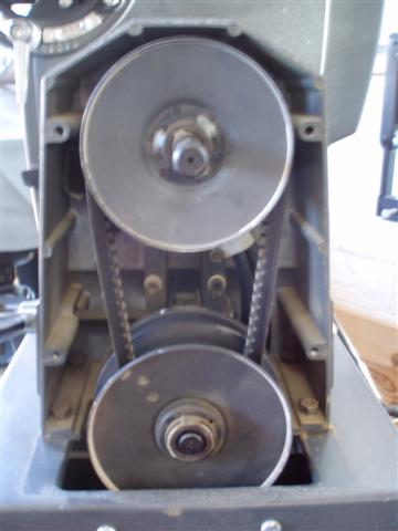

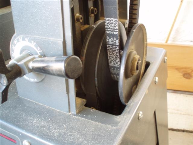

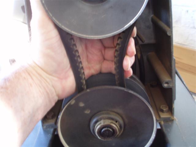

Evidence of the questions that I have about belt tension can be seen in the last of the following pictures.
You normally tension a motor belt for a specified amount of deflection and that amount is normally quit small (1/8" - 1/4").
In the last of the following images, you can see that I have a great deal more deflection than that. Now this image does not show the motor belt (it is out of camera view) but it deflects much the same as the one shown.
When running, these belts tend to flutter quit a bit and do make an unusual amount of noise due to that flutter. Tension on the belt shown in these images is not adjustable. It is variable, based on the speed selected, but tension shall be whatever it is as result of pulley ratios.
